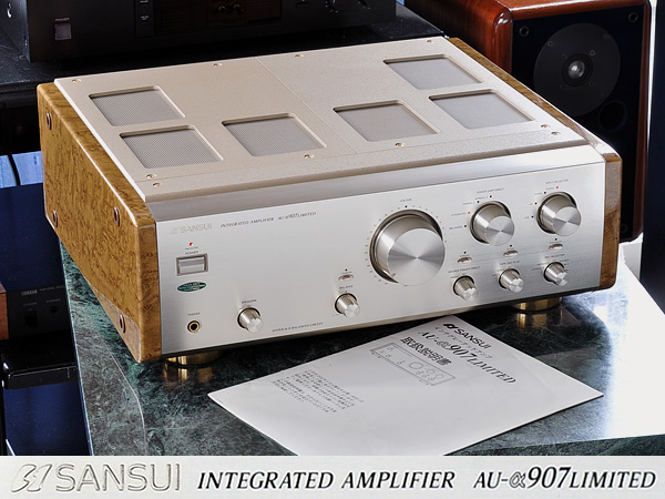

From memory, you didn't have the 907 Limited - you had the 907i MOS LIMITED
i.e. this one:
Not this one:
Yup . Ur damn right on.
