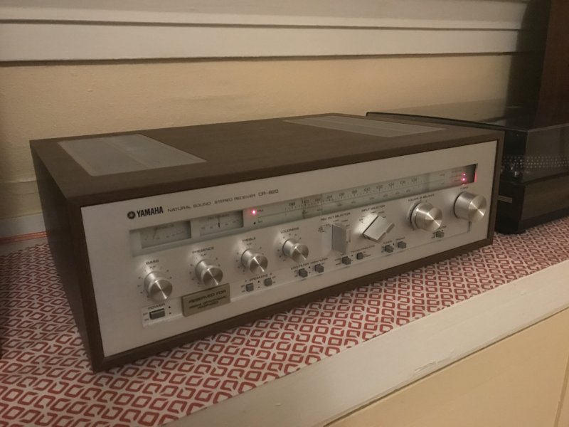

Hi AKers,
I recently picked up a gorgeous Yamaha CR-820 that had only been driven to church on Sunday. The only flaw I have noticed is that the lamps are all out. I asked a stereo shop in Berkeley who estimated $150-200 to replace the bulbs. I'm new to this, but that seems high.
I'm looking for recommendations for independent technicians or shops in the Bay Area, preferably in Oakland / Berkeley / East Bay who do good work for reasonable prices. Could you please share your favorite? I promise not to take up all their time :)
Has anyone had any experience with the technician at Strictly Vinyl in Albany?
Thanks a lot, Erik

You can't do it yourself? It's shouldn't be that hard. If the amp is working and you are not handy, I would just use it and forget about the light bulb. I won't even pay $50 to change the bulbs, problem is a tech has to open it up, look at the bulbs and likely has to order the bulbs to put it in. I can understand they are reluctant to even take on the job. Those bulbs might not be as common as standard resistors, transistors or capacitors that they stock in the shop.

This should be easy to DIY, the hard part is to find the replacement bulbs and is not much easier for a tech. Open it up, take pictures of the bulbs and post here and people can help. You really want to drive all over the bay area to get if fix? Take the cover off, post pictures and ask for help. People can show you how to do it.
If I were doing service, I would charge more on this also. I have enough transistors, resistors and capacitors to cover a lot of the repair, but I have to go on web to search for those odd ball bulbs and order it. Take me time to do the search, it's more work for me. Charging $150 to $200 is a very polite way to say "I don't want the job"!!!
Also, how much is the receiver worth? You really want to pay to fix the light if the thing is working?

That's the spirit. Any question, just post pictures and ask. Remember the site Rob posted where to buy vintage bulbs in post #8. That would be my biggest concern of buying those really old bulbs.
Even if you have further problems, try DIY, learn how to solder, get a decent soldering iron and ask help here. It's not worth paying hundreds for service. You have to look at how much the amp worth vs cost of service.
You can do it yourself - no problem! Those bulbs just pull right out, then connect the wires.
Just don't drop any solder blobs!
And move the tuner dial pointer away from center before pulling the case off, and putting it back on.
