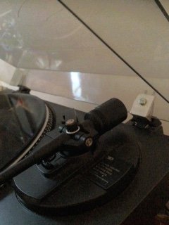

Since working out the initial repair for the broken tabs that plague many Technics dustcovers, I've come up with a much, much simpler way to accomplish the same results. The first design, discussed here, was certainly an effective solution but the replacement pieces were pretty difficult to make, especially with hand tools like hack saws and files. That prompted me to try something much simpler.
The pieces are merely 7/8" long pieces cut from 1/8" thick 1" x 1" aluminum angle. The only other cut is to shorten one leg, the one that slots into the hinge, to 7/8". You also have to drill one hole through the leg that's screwed to the dustcover, not two as before.
As you'll see below, the hole in the dustcover is in between each of the two pairs of ribs on the back of the dustcover. The space between them is small, about 1/4", so the choice of screws is important. As it happens, the nuts for 4mm machine screws are a perfect fit, so perfect that the ribs prevent the nuts from spinning when you tighten the screws.
One screw per side is plenty strong enough. The only thing a second screw might do is prevent the hinge piece from rotating but the placement of the aluminum angle against the back and the edge of the dustcover prevent that anyway.
So, now all you guys who didn't think you could do the job yourself have a solution. ;)

Really nice work. Would it make any sense to put a piece of rubber somewhere in there to keep the pressure from further cracking the plastic? One of my covers (which is still in good shape overall) has tiny cracks exactly where they are in the photos.
It might but my sense is they'd need to be thickish to work.
John

This is awesome. After breaking mine, I'm glad to see there is a workaround. Quick question. Best method to cleanup or remove remaining material on dust over before doing the fix? Small saw and/sandpaper maybe is what I was thinking. Don't want to crack the thing in the process. Thanks!
Yes, as described in my original thread here.
John
I used the file from my leatherman wave. Was a bit time consuming, but very precise, and since removing just enough, fits onto the spring hinges extremely tight.
I used a file as well but sandpaper would be fine as long as you use a block.
John

I only replaced the one broken leg (controversial!) partly because i only had a blunt hack saw and cutting through one was quite enough, and party because i quite like them being different; a reminder of some humble diy. I consider it like an nhs hip replacement.... just fix the dodgy one.
I used the new technique of just one screw.
holds fine, feels good.
