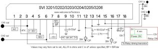

Read the number off of this black thing:

That box says SVI 3205. That relay you are talking about is the one you are thinking off. The power relay?
The relay is for Speaker (and headphone) protection. If it doesn't work no sound will come out.
SVI 3205 if the Power Amp module. Same thing there, if it's broken you won't get any sound out.

How do I test the relay? It clicks when I turn the unit on.
I have been led to believe that it might be the SVI unit. Do you know how I could test that to verify it is the cause?
You should measure the resistance on the pins for the through connection to make sure you actually have connection through.
If we know the model number we can get hold of the pinout.
We'll use this to check what the Power Amp module is up to. Could be that it doesn't get power even though it's more likely it's dead.
