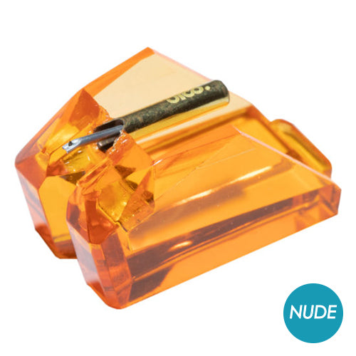

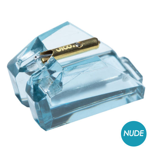

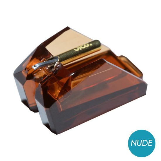

@dylan_k ,
For instance, the following styli share the same grip design so I'm assuming they can all be used in one particular cartridge body
@lini would be the one to ask if these are compatible
That would seem most likely, as the first gen. SL-BD20 typically used to come with that (while the second gen. (with additional suffix D) came with the EPC-P34CS instead). The original needles for that were transpararent orange, though, so the needle on your exemplar was probably already swapped for a compatible replacement some time ago.
All of these would be compatible, but I'd suggest one of the latter two.
