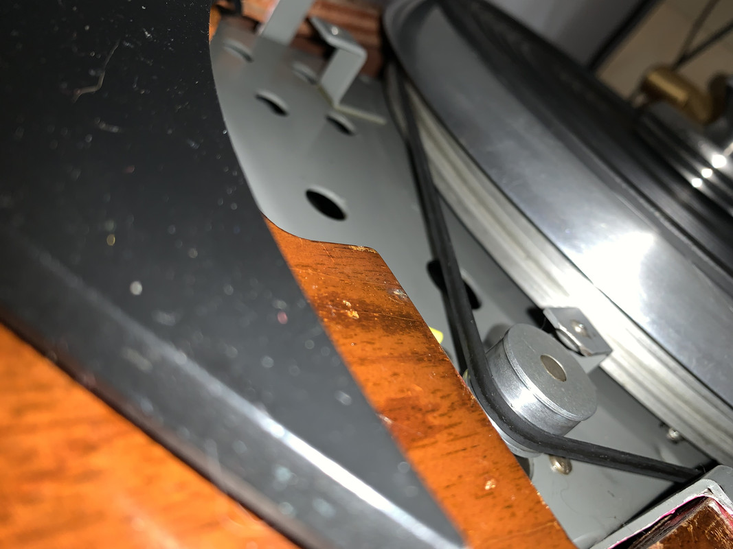

My 412-1 has a pop up 45 spindle, but the platter seems to only have one groove and I see no way it can change speeds. Am I missing something?
Can yo post a photo of your platters belt area?
VR
Andy
The best I could do without removing the platter and having to reset the belt, which can be a bit of a hassle for me. Basically the belt sits on the middle, indented rim, which sits between two elevated rims. In the past I've tried to place the belt on either of those but it ends up slipping back to the the indented one.
I guess the question is if there's a pop up 45 spindle, the platter has to be able to play at 45, correct?
Im sure that’s why Sam asks about the 33/45 grooves…mine has one larger track and one smaller track cut into the platter. Hard to tell from your photo.
VR
Andy
Now that one looks like it has a large track up high?
Yes and so does mine(does yours?) but when I attempt to raise the belt to play on it it slips back down to the center groove. Of course it could be the belt I suppose.
No I have the same issue, was messing with it yesterday, and could only get it to work by holding the pulley assembly up, in its normal position the belt comes off….Haven’t looked into it anymore, working on the plinth at the moment.
Ok thanks. I'm fine using it for only 33 as I have several other tables for any 45 use that I need, but was just curious.
