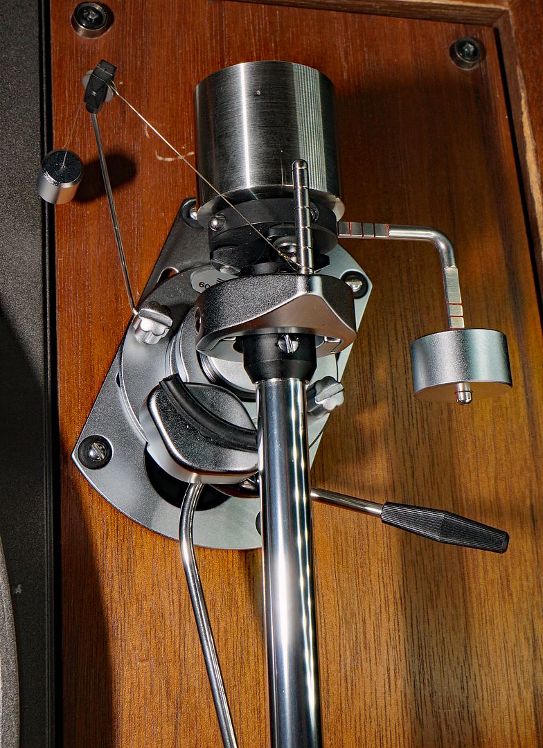

Some say keeping the main counterweight as close to the pivot as possible can be important for inertia reasons. But, you know what? A cm prolly won't matter.
I went to a two-step heavier counterweight and anti-skate weights on my SME arm for that reason. Do I hear a difference? Nope. I feel it is a bit too much OCD.
Notice how close the counterweight is. And I have the anti-skate weight on the shortest ring to the pivot.

I notice a lot less tonearm swaying L to R on records with a lot of dynamic range in songs when the weight is up close to the fulcrum... same record with the counterweight back near the end of the arm and the tonearm is moving around like a violin bow !

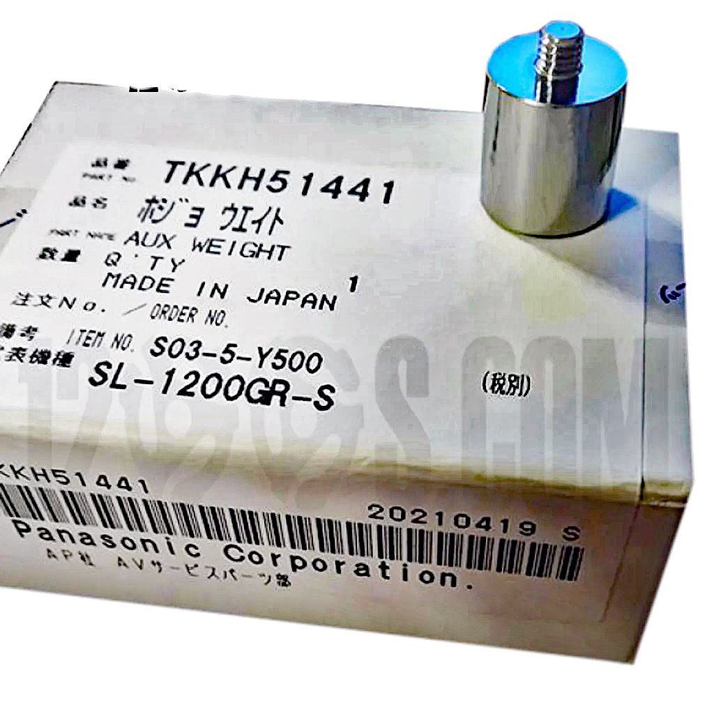

A Denon 103R will work on a Technics 1200 model turntable. You need to add this additional weight to the tonearm to get the resonance into a proper range.

Well, it all comes down to your ears. I'm just saying you can run a Denon 103R on a Technics, with an additional auxiliary counterweight. It's not a difficult procedure.

The new 1200 comes with an auxiliary counterweight yes? Or will I need something else?
