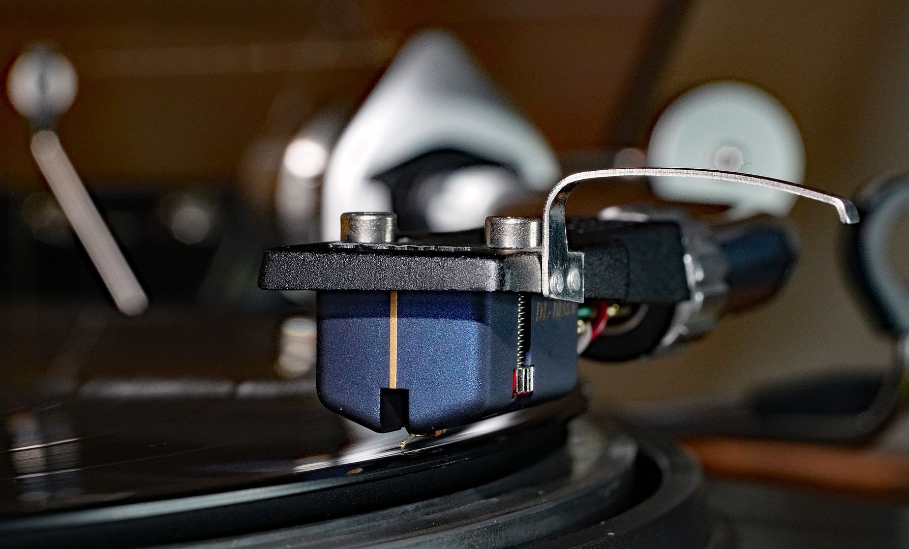

Hello. I’ve ordered a Technics SL-1200GR2. My first expensive turntable. (At least it’s expensive to me). I currently have an Audio Technica 540ML cart waiting. But I really want to try a Denon DL-103 or 103R. I ordered an AT 15g head shell. If I use the 15g head shell and the included Technics auxiliary counterweight, will I be able to run a 103 cart effectively? Thanks for the info.

Why use a cart with an ancient conical stylus profile ? There are better sounding Line Contact, Micro Ridge, and Shibata styluses out there for less $$ than the Denon 103. Also that Denon is a pretty low compliance cart so you would need that heavy headshell and not use the 10 gram counter weight. Also what phono preamp are you using ?

I’m new to this don’t always make the best decisions. And I’m still interested in doing despite your post. I’m curious to hear what the Denon will sound like in my system. Even you though it’s less than ideal according to you. But I appreciate your feedback.

I tried to get my arm mass to ~25g. Your heavy headshell gets you to 19.5?
I am running a Denon DL-103SA (similar to the 103R) on my SME 3009 Type II Improved arm (which has an even lower mass than the Technics).
I needed to add a heavier counterweight (138 grams vs. the standard 110 grams). A heavier anti-skate weight (4.5 grams vs 3 grams). A heavier solid Sony headshell (total cartridge and headshell weight is 17.8 grams). Resonance - 8Hz, also.
sort of . you cant just add up grams and expect it to come out right.
what I'm saying is if you add 10 grams to a 12 gram tonearm doesn't mean its eff mass is now 22grams. Its a bit more complicated.
Maybe I'm not understanding. :idea:
Yes, the effective mass is more. That's what needs to be done to use these types of cartridges.
But the stress on the pivot's bearings may not be that much different, as the tracking weight and movement of that arm are about the same.
I use a test record to check the resonance, tracking ability, and anti-skating settings — not calculations or graphs based on the tonearm manufacturer's data. Does that matter? I really don't know, but I have no issues with the setups.
