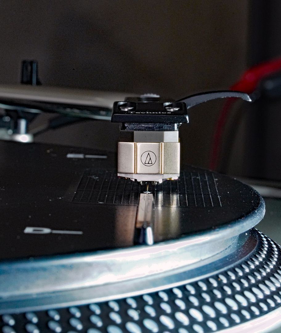

Audio-Technica 33Sa MC cartridge with added counterweight. Resonance is 8Hz.
I see that your counterweight is also close to the pivot, which makes for a smooth running table. I'm getting 9hz resonance (horizontal and vertical) with the added weight on the end of the tonearm and the 8.8 gram VM740xML, this cart is superb for a MM. I can dial back the anti-skate to 1.5 and pass two test record tracks, it needs 2.0 to make it through the third, and 2.5 to get through the fourth one.
:thumbsup: This reduces the moment of inertia. A lower moment of inertia helps the tonearm by improving dynamic tracking. That's why going to a heavier counterbalance, closer to the pivot point, is desired over a lighter weight further from the pivot.

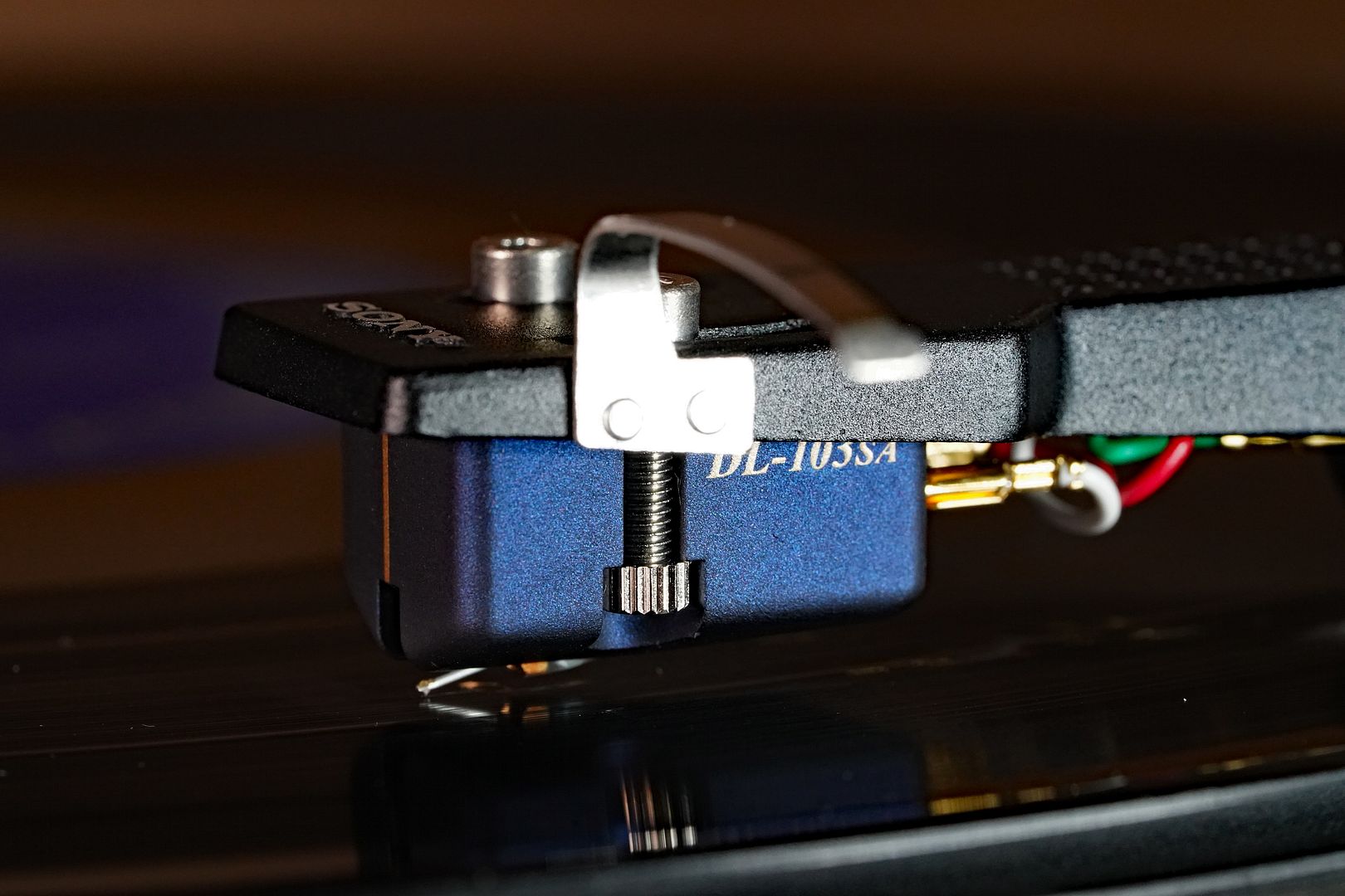

For the SME arm on my Sony, I chose the heavier 138-gm counterweight (the OEM stock is 107 grams) and the heavier Sony SH-135 headshell, paired with the Denon 103SA, to achieve a resonance of 8Hz.
DL-103SA on a solid Sony SH-135 headshell.
