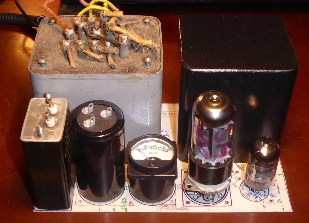

Same idea as my U-KT120, but compact version and using a 6V6GTA tube :
It started also years ago as a mono blocks prototype :
But it now takes shape - each mono block uses the same chassis format as my Micro-Amp Stereo project :
Lateral faceplate :
The parts and faceplates for the Micro-Amp, U-KT120 and U-6V6 arrived today, so these three projects will be able to move forward ! :cool::cool::cool:
Wait and See... ;)
T

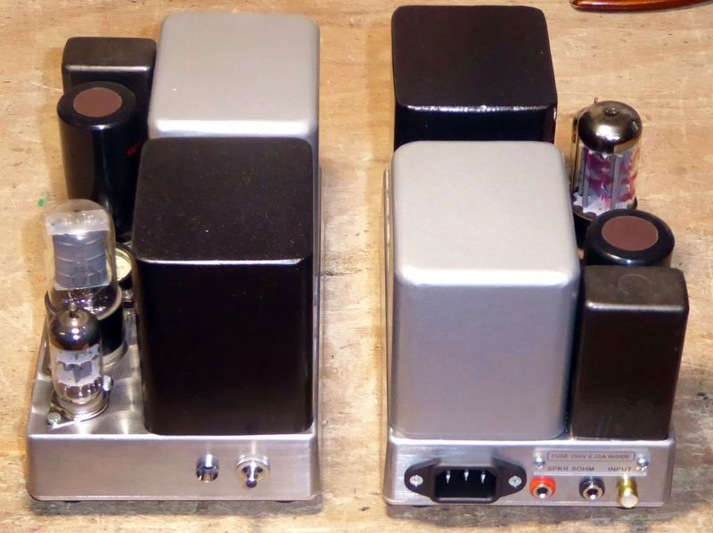

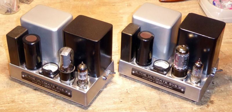

Around 5W output or is it triode? What are the potted outputs you're using?
It's an Ultra-Linear, cathode bias operation, with 2WRMS nominal output expected.
The output transformers are of an unknown Chinese provenance. It's a friend of mine who brought them from there as samples.
So I encased them and invented an obscure improbable brand for the fun... ;) These are 5K/8R, possibly 10-15WRMS transformers.
After a test on the prototype, they proved to be classic but fine output transformers...
The power transformer and the choke are French Army 60s surplus, from the brand LMT (Le Matériel Télephonique).

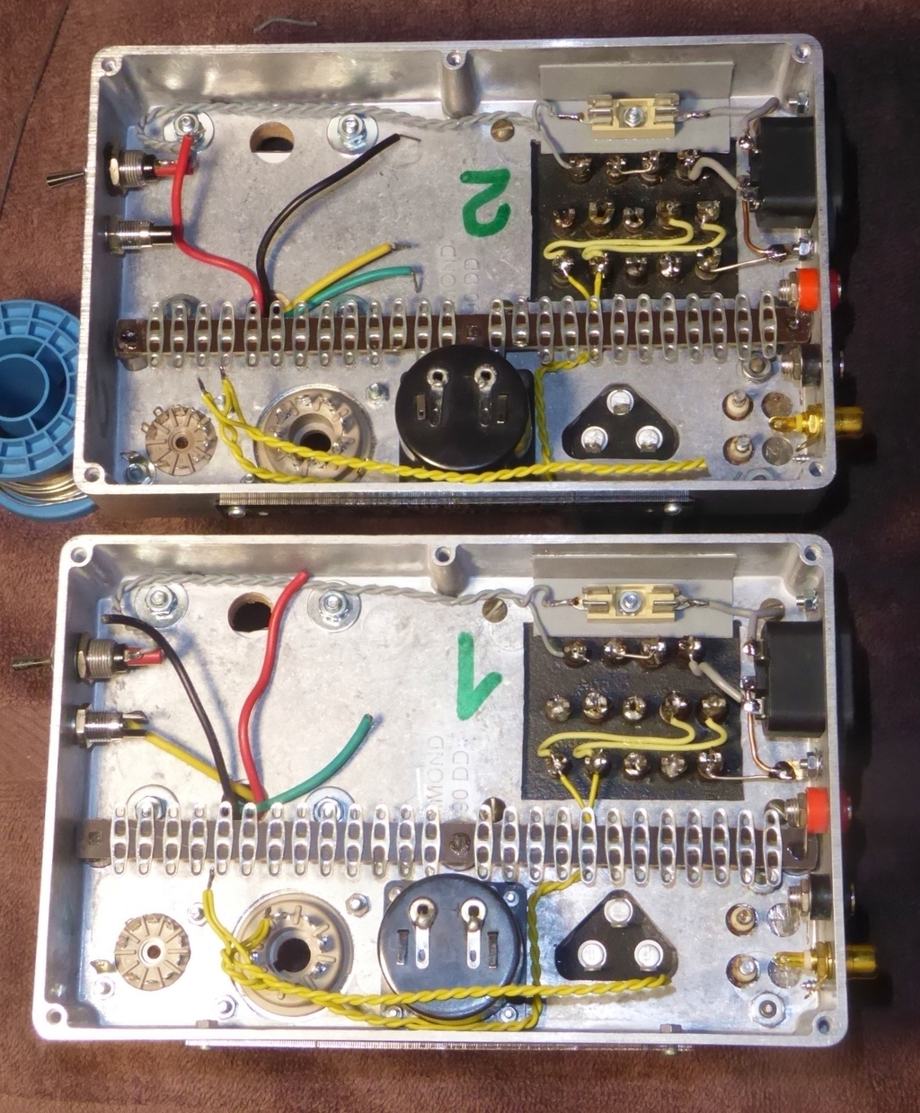

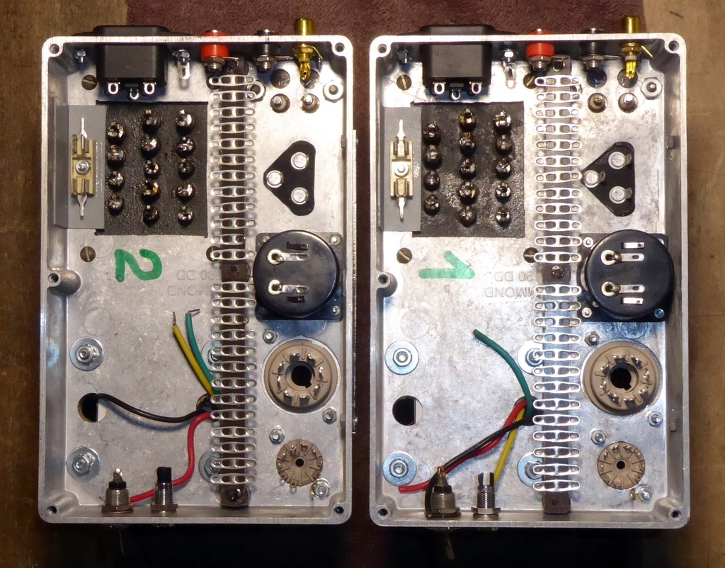

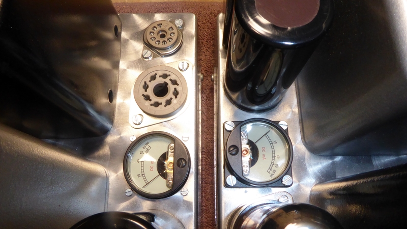

First, I modified the mounting of the meters, from upwards (at R) to underneath (at L) : nicer presentation...

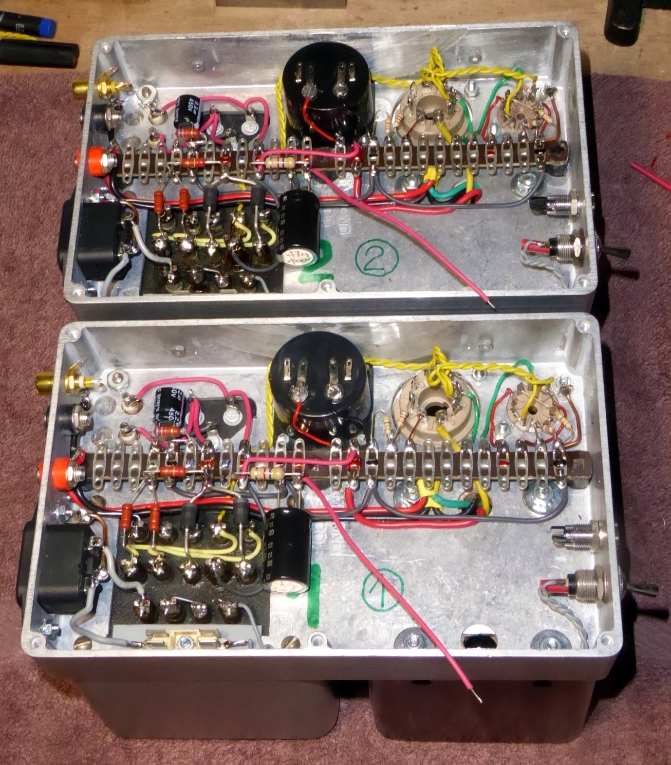

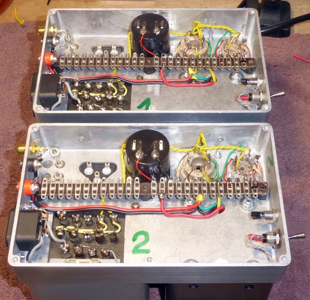

The chassis are ready for wiring :

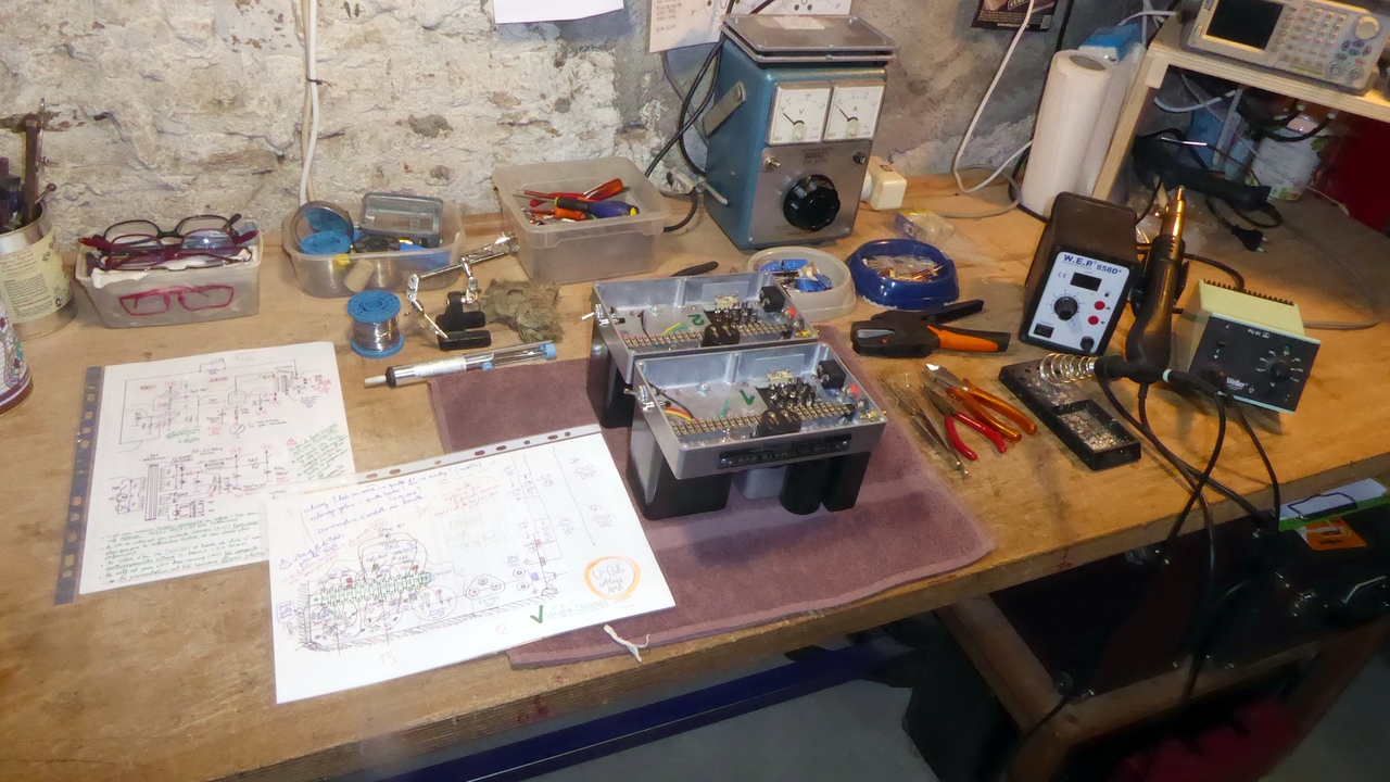

The workstation is ready for starting tomorrow (Sunday) :

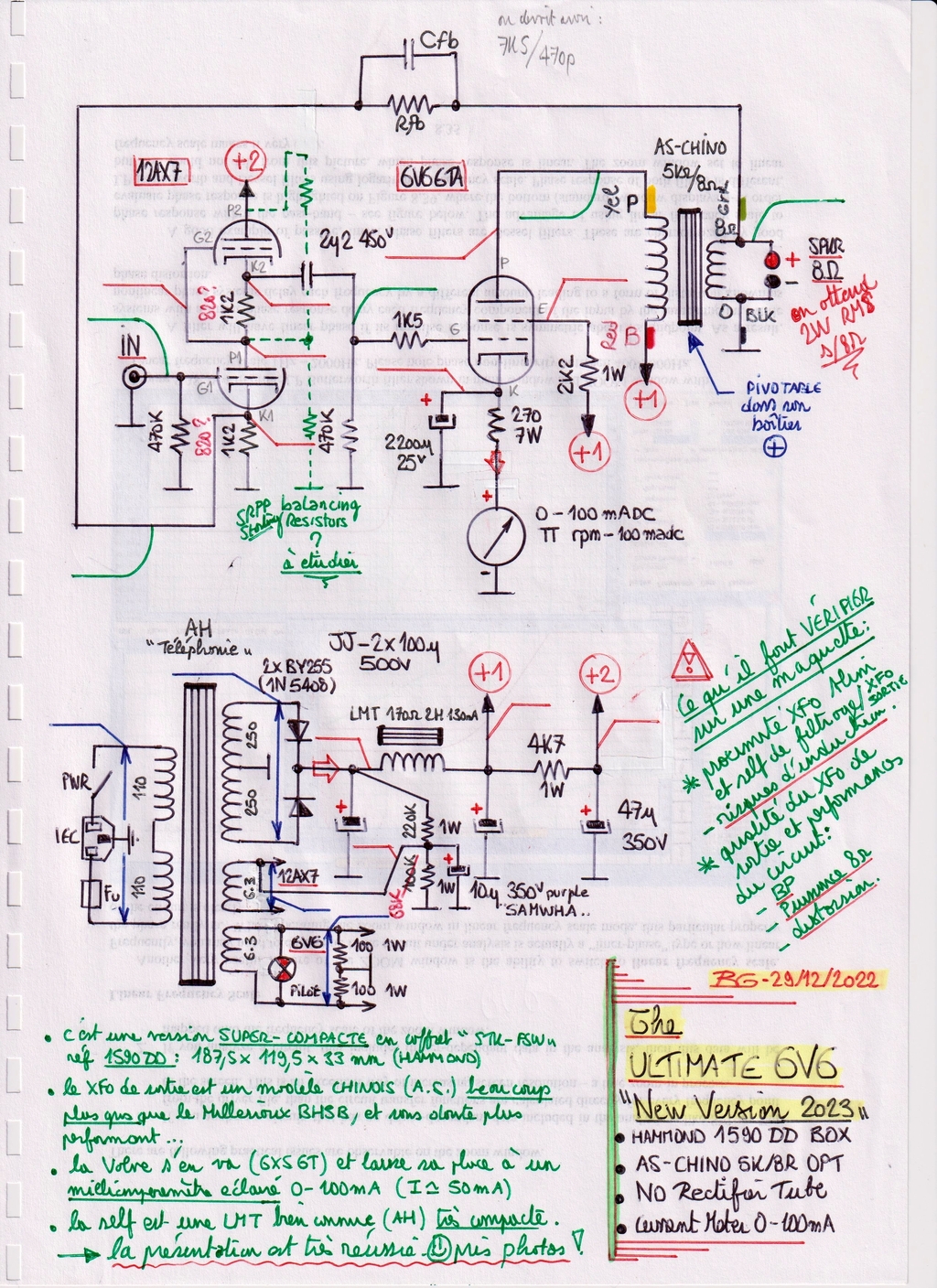

Schematic principle - I wonder about the usefullness of a Triode / Pentode switch... :idea: :crazy:
T
Some people like triode mode, some don't. I have pentode/triode switches on one of my stereo amps, and a pair of mono blocks. I wasn't impressed with triode mode at all. I just left that option out of a single ended amp I built.
Yes @Lavane - thanks ! :cool:
I have too been disappointed by all my attempts on Guitar amps by the Triode/Pentode switch : it lowered the power as expected, but provided a dull, lousy sound in clean and anemic in overdrive. So you confirm in Audio - at a lesser extent - what I noticed on Guitar amplification...
OK - I forget that T/P idea and stay in P ! ;)
