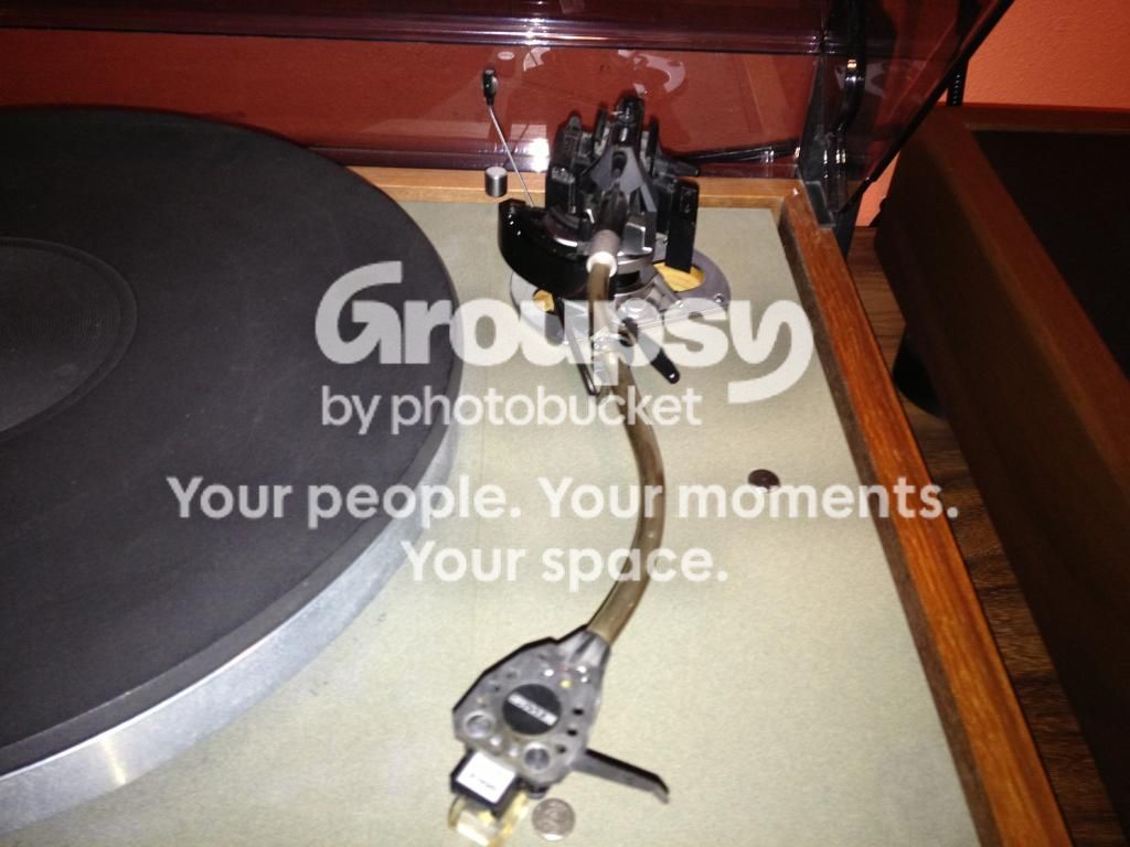

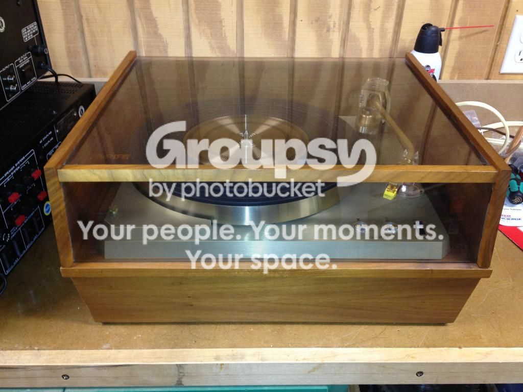

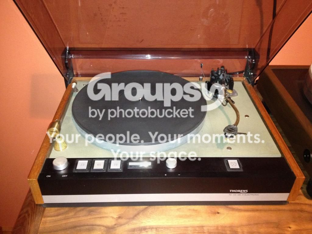

I have a Thorens 126 MK III with a SME 3009 Series III tonearm and a Grace F-9L cartridge and an Empire 698 with standard equipped tonearm and an Empire 4000 DII cartridge. Both are fully functional and in exceptional cosmetic condition. The Thorens has the original box and manuals for both the tonearm and TT.

Are there long term issues that should weigh in on my decision? I did have to repair the tonearm on the 698. The plastic at the end came off, but it was a clean break and I fixed it with Tenax 7R plastic welder. Works just fine now.

I'm not sure how the two tonearms ultimately compare. The SME is certainly more complicated. Aesthetically the Empire is gorgeous IMO. I love the gold tone and the tonearm is beautiful too.

Drool..... lovely tables. If it were me I'd be keeping the Thorens simply due to the greater flexibility, but then I've always been a fan of the 126. That Empire is just stunning, though!
If I had that Empire, I wouldn't be able to part with it. So, there would be the automatic decision.

Both are nice tables. The Empire is bone stock and will just keep on getting more difficult to find or replace in it's condition. On the other hand you can change tonearms or "play" with the Thorens and not feel guilty about making changes or expermenting. Can't beat the looks of the Empire, it really has that "wow factor". Could keep it just for the the serious looks. I would pick or use the same or similar cartridge on each and see which sounded the best and keep it. medicmike

I was listening to my "last side before bedtime" and happened to recheck the Empire manual for cartridge setup and realized it has an illustration in Fig. D that shows the method for setting overhang: the stylus tip is supposed to be lined up with the front edge of the headshell. Mine came setup from the seller with the front of the clip even with the front edge of the headshell, putting the stylus tip way too far forward! :no:
Out of curiosity, I looked at the pictures you posted of your gorgeous 698 and it appears that your cartridge is just like mine was, way too far forward in the headshell!
I had to push the cartridge almost as far back as it would go in the headshell to get the stylus tip lined up with the front edge of the headshell and then make sure that the cartridge body was centered in the headshell (it can get off to one side when you move it back).
