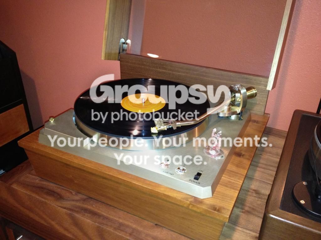

I wasn't able to get the cart as far back into the headshell as I'd have liked, but I did move it back about 3\16". When I moved it back far enough to align the needle with the front edge of the headshell it would not slip onto the tonearm. As it was it took a bit a finagling and trepidation getting the headshell on and the contacts working properly.I had to fix the tonearm end once as it is and figured getting lucky twice on this was pushing it.
Yep, the wire leads start interfering with the back of the headshell when you get that far back. The 698 headshell is definitely fidgety and delicate. I can change the VTA somewhat by loosening the collar and lightly holding the front of the headshell down and retightening. It also has enough play once tightened to allow for slight rotation to adjust azimuth.
I think that my headshell must be an aberration. Instead of the tonearm wires running through the sides of the headshell itself, mine attach directly to the solder joints on front of the black plastic piece. When I detach the metal headshell, the wires don't come off with it. Maybe someone modded it in the past. If so, they did a great job with the workmanship. Picture below is before moving the cartridge back in the headshell:
I suspect that your headshell was modified. The headshell should be completely detachable from the arm. Here's what it should look like:
At some point, the plastic headshell mount must have snapped off and a repair was done.
A word of caution: don't overtighen the collar when reinstalling the headshell. The old plastic tends to be brittle and if it breaks, it will really ruin your day.
Les.
I suspect that your headshell was modified...At some point, the plastic headshell mount must have snapped off and a repair was done.
Probably so. The rear-most metal back of the headshell slips directly into the metal collar protruding from end of the arm and tightens down. The black plastic piece is no longer a part of the equation of clamping the headshell to the arm. Whoever did this was a good craftsman. It looks "factory" and may actually be better than the original, excepting that the wires have to be removed from the cartridge leads before detaching the headshell.
