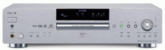

I actually have a cdp-559es that cd player is heavier than the amp :). What do you mean with sonys offerings in the US having been lacking? Haven't most of the same devices that released in Japan and Europe also made it's way over to the US? I am for sure biased since I really like sony audio equipment but as far as I can tell their higher end series like the aforementioned elevated standard line is well respected on forums like this. And while the singular es turntable (ps-x555es) is basically just a more cheaply produced variant of the ps-x800 it's still a really well performing turntable. The decks are also quite nice and I have actually heard quite a lot of the range, I currently have a k909es cassette deck which performs really well and is considered as one of the totl offerings. Haven;t heard many sony amps to be fair. The v-fet amp I used before is also a sony amp but v-fet stuff is not really representative of the standard sony amplifier.
I have three different Sony disc players, two are ES, all are spectacular.
They look good with vintage silver faced gear as well.
Sony DVP NS 900V
Sony DVP NS 999ES
Sony DVP CX777ES
