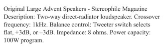

I recently purchased 4-each vintage Advent Loudspeakers . I believe these are the vinyl wrapped models .
I have a question regarding how to configure these units stacked on my current receiver .
The receiver is the Toshiba SA7150.
Please forgive my ignorance in asking , but I don’t know enough about what’s safe or how to configure speakers to my unit in a safe manner that will not damage my receiver or speakers .
What I’ve read online is that you can wire 2-each 8 ohm Advent Loudspeakers cabinets in parallel to achieve a 4 ohm impedance load as long as the receiver can handle the 4 ohm configuration.
My receiver shows the following speaker configurations,
Speaker A- 4-16 ohms
Speaker B- 4-16 ohms
Speaker C- 4-16 ohms
Speakers A&B 8-16 ohms
Speakers B&C 8-16 ohms
Speakers C&A 8-16 ohms
My question is (or what would be less strain on receiver) should I configure stacked Advents in a parallel configuration only using Speaker A( left and right channel ), or
Should I configure 2-each Advent speakers on Speaker A,
And 2-each Advent speakers on Speaker B,
What are the pros and cons using 4 ohm or 8 ohm configurations?
I’ve heard that older vintage receivers (like the one I have ) are sensitive to low impedance loads and can damage internal components , this may be a myth , but I’m asking the techs on this forum because i value your knowledge and opinions .
Attached are some pics and details of my project.
Thanks for all the support and advice ,
Bernard

Wiring all four speakers in parallel from A is the same, from an impedance standpoint, as running one pair from A and one from B, because A and B are wired internally in parallel anyway on that amplifier..
Those speakers would more correctly be rated at 6 ohms, so in parallel will present a nominal load of 3 ohms or even lower. Based on its recommendation to limit simultaneous speaker usage to 4 ohms, your amp may not be built to deliver the current demanded by a 3 ohm load on a sustained basis, especially at louder volumes.
You could wire them in series to maintain a "safe" load. This will, however, reduce the amp's maximum output by 50% (3dB).
That said, given the significant difference in the Toshiba's rated output into 4 vs 8 ohms (an indicator of power supply "stiffness"), I would probably not be overly concerned with running your two sets of Advents in parallel. Just keep an eye on how hot the amp is running.

The label states 8ohm , but that’s what the label reads , it could be lower or higher , could I measure the resistance on all four cabinets and if it’s 8 ohms or higher would the parallel configuration still be an option, or are there other factors to consider (age of drivers and crossover components, etc..)
I’m ok with series configuration because I don’t like it loud , just nice sounding music .
I wanted to keep my vintage receiver aligned with vintage speakers .
So if I choose the series configuration , I would connect (1st stack) + from cabinet 1 to - on cabinet 2 , and - from cabinet 1 to + on cabinet 2, then take + and - from 1st stack to Speaker A Left Channel, and visa versa from 2nd stack to Speaker A Right Channel ?
I could also wire the 1st stack in series and measure the impedance across the stack making sure it’s at least 16 ohm or less .

Impedance is difficult to measure. Not the same as DC resistance. Impedance varies with frequency.
Regardless of being labeled as 8 ohm speakers, some of the resident Advent experts have determined that 6 ohms is much closer to their actual nominal impedance. This thread may be of interest:
As I noted, at moderate to lower volumes, probably not too much of a concern to run them in parallel with that amp. But if you want to assure no impedance issues, series will do the trick.
You understand that the lower the impedance, the higher the current demand, right?
