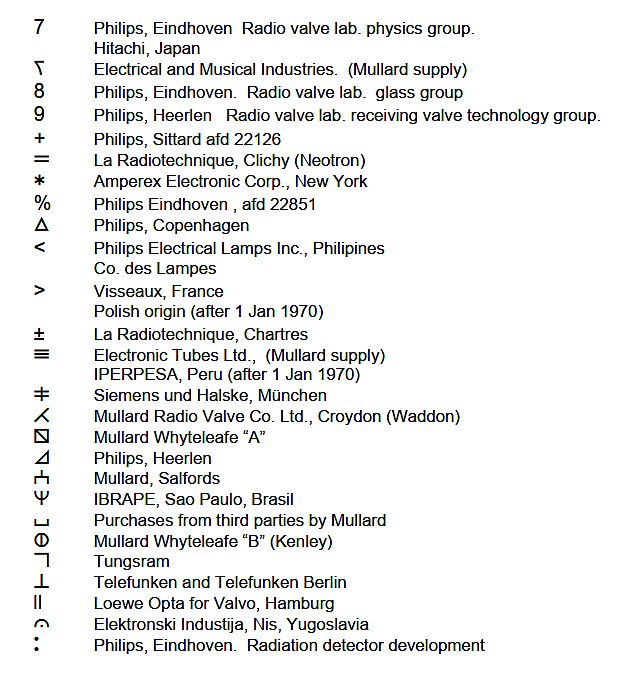

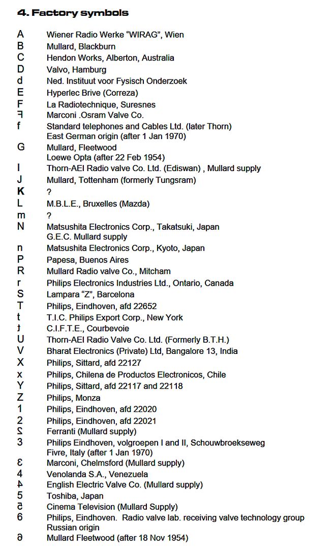

Some of the Phillips consortium manufacturers' codes. :)

There are several sites that have mfg/date codes.
Philips Tube Codes.
Brent Jesse Tube Codes.
1959 EIA Codes.
VivaTubes Tube Codes.
There are more online sites with posted codes. :)
