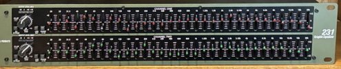

I too had a terrible problem with a bass resonance at 77Hz and somewhat poor imaging. At least the imaging was
better than my previous apartment, which had a room wider than long. I thought of tube traps
but our long time high end dealers dissuaded me. They also dissuaded me from $10,000 of new speakers because of the room.
I spent $140 on one of those UMIK-1 mikes, $140 on a Chineseium 31 channel equalizer, which came only
with XLR and TRS connectors, thus, another $80 for cables. I also used some old big rolls of foam I had for carrying things in my SUV.
It took quite a while to get both good frequency response in each stereo side as well as respectable imaging.
Taking room reflection responses with Audacity helped a lot. But I eventually succeeded. The curves on the equalizer
are quite agressive, though the range of each slider is only +- 6 dB.
I'm attaching (I hope) a graph of the response at the listening position (the big black chair in the middle of the room)
and a picture of the rather cluttered room, 1/4 of the way from the back wall. On the right side of the chair is my main computer and
on the left is my ham radio setup. It also took lots of work with ferrite clamp on chokes to get it where I could
listen using while transmitting digital 100W ham radio. On all but the lowest band its now totally inaudible. (Being entirely digital
the ham setup only makes a tiny fan sound.) The main speakers are KEF105s, the backs 16 inches from the
lit end of the room. The main TV is off center between them. The small white chair damps the floor
reflection from the left speaker. I'm still looking for something a bit more decorative. The response difference between 20 and 400 Hz
helps the imaging. Its remarkable how big a listening area works OK ... its between the computer and ham radio
and about 8 feet total front to back.

By the way I think a parametric EQ would serve you much better than the graphic you got. They come in hardware as minidsp.
Why would a parametric be better? It would need at least 20 or more parameters ...
something like five frequencies per channel, with 5 Qs. It would be a nightmare.
The settings on the 31 channel are nowwhere near what computer programs suggest ...
those don't address what I hear in my ears as imaging.
Please explain. Do note that the 31 channel goes between my main surround sound receiver
"stereo" preamps outs and my main R-L amp, while the surround and center speaker use the
receiver power amps.
Because of this I get lots more real power.
I've never "understood" why a parametric would be better. People do say that ... but there
is no explanation.
Parametric eq's can be a lot more flexible but also more complicated. Better or not would be up to you.
There is a parametric eq built in to the DSP-408 and I found it easy to use.
In terms of eqing speaker response and taming room modes, PEQ can be substantially more accurate, with q curves tailored to match those precise frequencies affected by the room modes. Most DSP crossovers will have 9-10 per channel, so 30 bands for 3-way speakers, which is usually plenty. REW will generate parametric eq info, I’ve found it to be quite reliable.
