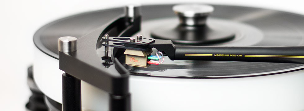

If a stylus moves, it will generate a signal. The RIAA playback curve means there's a huge amount of boost at very low and subsonic frequencies, so the signal produced by the cartridge ends up being very large after passing through the phonostage. The IEC proposed an amendment to the RIAA curve to mitigate the problem but it was never widely adopted. Worse still, some phonostages don't adhere accurately to the RIAA specification and actually apply extra boost at subsonic frequencies, making the problem worse.
Well matched arm effective mass and cartridge compliance which puts the arm/cartridge resonance at about 10Hz will help, but there is one other possible solution to the problem and that is arm damping. It is possible to damp the motion of the tonearm at subsonic frequencies and it is very effective at eliminating "cone flapping".
This is the best implementation of arm damping, but there are other ways to do it.
Cone flapping as mentioned above is the result of using a damn turntable for your input signal. Without a low or subsonic filter the table no matter what it is, is going to put crap into the signal at low enough frequencies to cause woofer movement. Some folks like to look at that and think it is cool. Since we hear to about 20Hz any movement slower than 20 times per second we can't generally hear and could be eliminated from the signal to save amp power and woofer movement for what we can hear. If you see the woofer wobbling, it is lower than 20Hz.
You can try to do things to decrease the woofer movement or eliminate it but it will require a filter or damping of some sort. It is just the nature of the beast. Fortunately all this old crap we love so much doesn't sound really terrible when the subsonic filter is used. Some, maybe many can hear the difference, not usually a lack of bottom end as the subsonic filter should be below hearing. The low filter might dip into the music and take away the lowest bass and I don't usually use that one but on units that have the subsonic filter, unless I'm sitting there concentrating on what my equipment sounds like I use it.

Sony's setup = 8-9 Hz resonance (modded Denon DL-103R on SME 3009). Technics = 10 Hz (AT 33Sa on stock 1200Mk2).

Do you know what is the resonance frequency of your setup? I have issues when the Hz < 8Hz. Usually too heavy headshell + cartridge , for the particular tonearm. And/or compliance miss-match issues.

I’d have to measure them. I use Technics EPA-500 arms on my main tables. With 5 different EM wands I typically just grab the wand that should work and don’t worry about it. On the combos that aren’t great I engage the 10Hz filter on my DSP crossover.
I was thinking of experimenting a bit. For Example my 150MLX will pump woofer on an 8g wand, so I was going to stick it on a 6g to see how it behaves.
