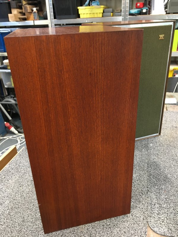

I was lucky enough to pick up a pair of completely original W2's which have been the prized possession of an old chap (from new) until he recently died. They are immaculate externally, in oiled teak veneer cabinets, and I'm definitely going to restore them if I can. (do you agree?)

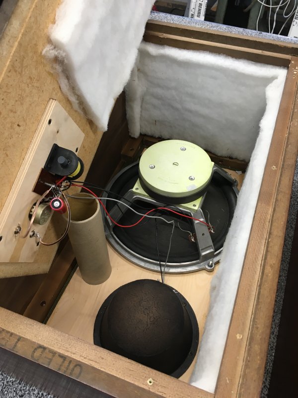

Both sets of drivers are still functioning, (after cleaning the wire-wound tweeter control) but the sound is harsh around the mid-range. You can hear the potential of the bass though, almost ethereal in its roundness. A very brief inspection reveals the insides are completely original. There are simple single-order crossovers with a choke and a cap, so I will start there with new caps. (any suggestions for brand gratefully received).
The chassis' are mounted from the rear of the baffle (I have not removed them yet) and from what I can see/feel the annulus rings on the woofers appear to be rubber, certainly not foam. The rubber feels quite stiff and I'm wondering if this is part of the problem. I'm confident enough to attempt new rings if they are available.

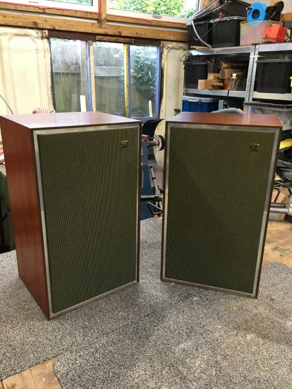

That thread has some legs so it's worth having a look there too, but for now here's progress of a sort... here they are:

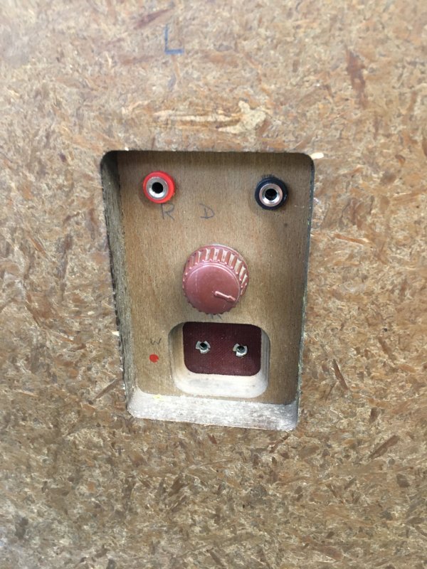

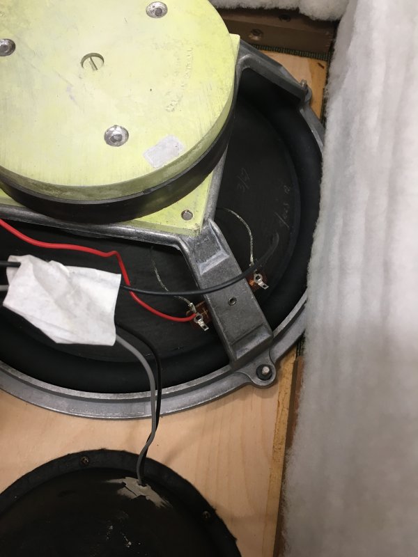

I've cleaned and refinished the cabinets... There's a nice silver detail to the fronts, which as far as I can ascertain was only used on the W2 model. Inside is pretty basic but tidy enough.. However, there is something strange going on, one of the bass units has been reverse wired, not by mistake but deliberately, whoever did it has actually reversed the markings in the connection plate (compare with other pic and you'll see what I mean). Don't know why, maybe it has had a new coil at some time and it was installed wrongly (is that possible? I have no idea). Once I get the caps installed (still waiting on mr postman) I'll need to do some testing they might just possibly be out of phase. Other than that all I've done is add some banana connectors because the original sockets are fairly crappy affairs and very temperamental. Now I'm waiting with bated breath for the caps to arrive. I have had time to really look at the drivers and they do seem intact and research says they are highly damped woofers so maybe that explains the stiffness, I'm more used to modern drivers wilt long-throw excursions. I'll need to see how they sound, but the surrounds are actually quite supple so they may be OK.
Well after a long wait, my caps finally arrived from Estonia! I have just replaced them and...transformed! So this is difficult to quantify. First, it is true, they are not bass-heavy, I rather they are bass-projecting. But the bass is, well, best I can say is it has punch, and it seems omnipresent, you can't tell where it's coming from.
The presentation from these speakers is so different than I am used to. I can be pretty certain now that there is nothing wrong with the drivers. Acoustic instruments are clear, precise, and superbly staged, vocals are articulated and everywhere! Cellos and bass instruments are so powerful. (I know, I've had to pinch myself, I can't believe I'm describing a pair of speakers probably the thick end of 55 yrs old) but honestly, I found myself snooping around the sides and back of the cabs, convinced there was somehow another port or 'something' I hadn't noticed for an additional element to spew from. Very, very strange, but beautiful, just exquisite. So different from the wallowing and deep bass of the Q55's or the restrained bass of the Q35's (that's all I have to compare them with). I can feel it in my chest rather than rumbling my belly. That's obviously the difference a well-damped 12-inch driver creates.
They are definitely much more placement-critical, (which doesn't make sense, them being front-ported), but raised 10" off the ground and given some space and they come alive. And I love them.
