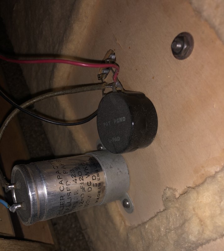

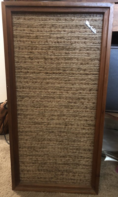

Hello, first time poster/long time reader here. I picked up a pair of Wharfedale speakers yesterday at a thrift store for $40. From what I can tell, they appear to be W60's. I popped open the backs and looks like the cabinets were manufactured May 29, 1960 and the speakers are from July 1961, from the crayon marking on the speaker. Tweeters sound good, but woofers are farting out consistantly. I'm curious still because all other pictures I'm finding of speakers of this era of Wharfedale have a coil mounted next to the L-Pad and cap. As you can see in my pic, I am coil-less. It looks like the speaker in the pic has a mount for one, but the matching speaker doesn't have that extra bolt/nut or hole drilled there. Anyone know what's up with that? Also, I'm guessing recapping will fix the woofer sound? Thanks for any help here! :)
Hi! and welcome. I'm not a Wharfedale expert, but yours seem to be the W30 speakers.
Hopfully someone will chime in or you could start a new thread..

Wharfedale sold some speakers called expandables. This was part of the w series. I do not know a lot about them. Your speakers might be part of that series. I believe they would have been refered to as the E60's then. I'll let you know when the literature arrives.

PierceH, what woofercooker said is correct. I think those are w30's. That is one model I have never run across or seen. I cannot comment on coil vs no coil on them. I can state the capacitor is fpr the tweeter. I can't see how it would cause a woofer problem. Changing the cap would likely help those tweeters, but I think there is another issue going on with them.
