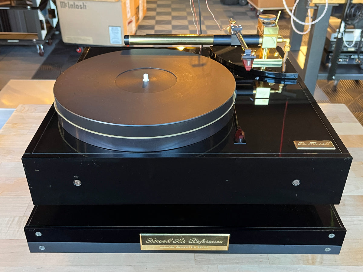

Is 1990 vintage?
A beautiful turntable, certainly very technical and interesting. But when it comes to performance, is the price really justified by what it delivers? Its price is astronomical.
When it comes to units only made a bit more than 100 it becomes collector items not because it nessecarily are good but instead rare.
Yes, rare things are often expensive, but personally, I’m not just buying an object. I’m also buying what it allows me to feel.
And as the saying goes, “You get what you pay for.” But, with a high-end turntable, the price is not necessarily justified by specifications or measurable performance alone, but also by engineering, execution, refinement, and the listening experience. The real question is not simply whether it is expensive, but whether it brings something genuinely special.
