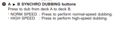

According to a JVC manual (if that's what you have) Synchro dubbing is copying one tape to another either at normal speed or high speed (see excerpt from JVC manual). @gadget73 described it above. It is used to make a duplicate tape. I think if you wanted to make a mix tape you would manually cue-up the song on the play deck slightly before the music you want to dub, place the record deck into REC PAUSE, start the playback and release the pause. Hit pause again when the song is over to stop recording and cue up the next song.
