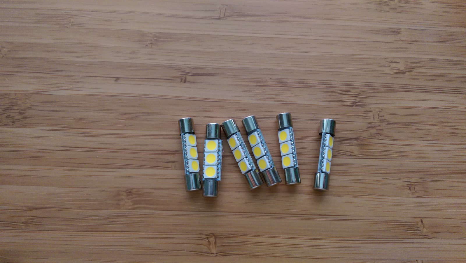

Hello. I know how this has been done because this is my Superscope R-330. The original lamps are replaced by warm white leds. I you place original 8 volt 250 mA lights, it's magenta (pink) again. So no big chance. The leds are easily placed.

Well, just replacing with warm white LEDs just makes the pink a bit whiter. I tested color with a blue camera gel. First 3 on right are LED and me holding blue gel in middle. I then cut the blue gel into strips to fit in the LEDs and insert them.
Easy to change back for purists and weirdos ;)
It's looking Marantzified now.
