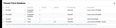

The Pioneer part number for the SA-6500II power switch is ASK-065. The following indicates the other models that use this part.
