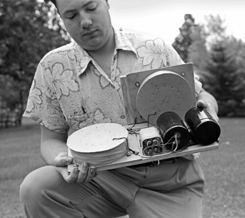

For your dad yeah good enough was probably on his mind and not many in his day were looking to do things like that, that are found on this forum today. But believe me a few did venture there.
This guys dad was a NASA Engineer in 1961, notice the size! Of these Klipsch Networks
