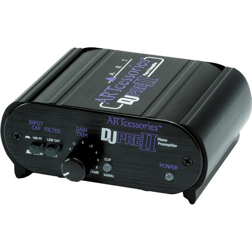

Ok so I'm not exactly new here, but its been a while since i came around.
My set up is as follows
Pre amp/Receiver - Yamaha RX‑V663
Power Amp - Crown Macro-tech 3600vz
Speakers - Mitsubishi Ms-20s(powered by the Yamaha receiver)
and Infinity Renaissance 80s(powered by the crown)
Subwoofer - M&K VX-1250sf
Turntable - Numark Pro tt-1(not yet hooked up)
So here is my dilemma, I've already dropped a good amount of money on all my system components and am not really looking to buy yet another $1000++ component. I know the weakest point of my system is the receiver but it also has many benefits such as remote function, 130wx2 internal amp, video processing, and more. The downfall is I do not have a phono input. I am curious if there is an affordable phono pre amp that will perform well. My system is very clean and clear with virtually no noise floor and I would like the pre amp to maintain that. I am only 24yrs old and i have already spent more on my system than any one car I have owned and don't get me wrong its very rewarding but I'm just not looking to throwing another small fortune at it right now. If anyone knows of any diy phono pre ams that would be good to. I actually would prefer to do a diy one if its available as im always looking to learn and I have the tools/skills.
Any help would be great! Thank you in advance!
Sure -- there are a plethora of storebought, kit and pure DIY phono preamp options.
Dollar for dollar, I like this one. Lots of flexibility in an inexpensive package.
http://artproaudio.com/turntable_preamps/product/djpre_ii/
about 50 smackers.

Lots of options in the sub-$200 category. Personally I would start with a standalone phono preamp. Set a budget and narrow down options based on that. The Art shown above is the cheapest thing I would consider worth buying at typical prices (e.g. not used or on sale).
I am pleased with my Art DJ and Emotiva XPS-1. Both are very reasonably priced.
Seconded. I have both.
My only complaint about either is that they both have the BLAZING BLUE LED LASER OF DEATH. My main system is in my largish bedroom and I have to mask or hide the power lights.

Most usually that would either be pretty difficult (as in quite a lot of cases the phono section isn't on a separate board) or not worth the effort (due to the phono section not being all that great) - and then I wouldn't put a phono stage in a plastic box anyway. I.e., if you'd like a bit of DIY, but not all that much, you could start with a a priceworthy module like the AudioWind/Electronics-Salon A-310 or A-300 - the latter basically being a Bugle clone, whereas the former is a typical Lipshitz-like implementation, as can be found in quite a lot of both stereo and surround receivers, integrated amps and priceworthy separate phono stages, but despite the low price already equipped with a pretty decent opamp (TI/BB OPA2134) and several dip switches for various loading options and choice of gain. And iirc they also offer a matching power-supply module, though to me that didn't seem to be that attractively priced. And those were just two examples...
The Art DJPreII also is a Lipshitz-like implementation, btw, but with an additional output-stage with variable gain. And it's pretty well-equipped and also well-made for the price. Main disadvantage is its rather low internal operating voltage - just (not quite) +5 and 0 V asymmetrical, so that it's got somewhat limited reserves compared to otherwise similar Lipshitz-like designs running at higher and usually symmetrical voltages like for example +15 and -15 V.

I figured it would be more work than its worth to remove the phono pre amp section of a receiver. why is it you wouldn't put it in a plastic box? is it do to interference?
I couldn't help but notice the bugle3 looks as if it comes in a plastic case, and it cost over 200usd. the a-300 and the bugle2 both have my interest. I have gone way to far to go cheap here, so ill do some research on the two before i make a decision. May have to look into fabricating a metal case for it unless wood is ok??? :dunno: I would rather wood as I am skilled at woodwork and could make something that looks good sitting there with all the other high end components.
Thank you all for the input!! Any further experiences with Jim Hagerman's Bugle or the AudioWind/Electronics-Salon A-300 would be much appreciated.
