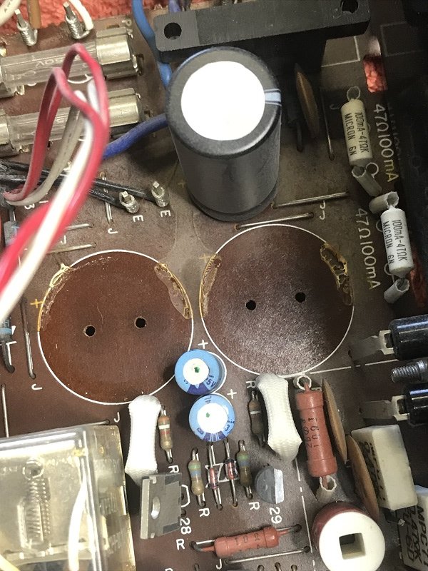

They all look Fine..Reinstall in there proper sockets. New heatsink compound recommended on both sides of the mica insulator . The old mica can be cleaned and reused.Mica doesn't tolerate much flexing..;)

Thanks I have some heatsink ordered. I will take care of this later in the week. At least it does not appear the outputs are shorted.
Its likely a power supply or protect circuit issue.Will need to make a couple voltage checks at the amplifiers outputs..Then press on to other areas.

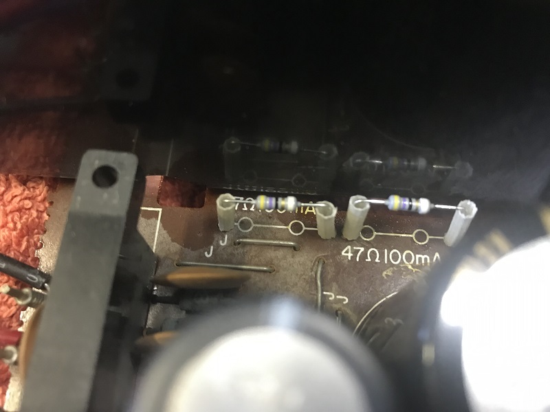

Just a thought, there are two 47 Ohm 100mA “fusisters” on the board.
They are the white things on the right. They are both 100mA fuse and 47 Ohm resister rolled into one.
Measure both, if they measure “open circuit”, then replace with Vishay 1/2 Watt 47 Ohm flame proof resistors.

Thank you MR Relish and Avionic for your troubleshooting assistance. I received replacement fuzes. I installed one and turned it on. without speakers connected. Lights are back on and I hear the relay click. This still doesn't answer why it blew in the first place. Oh and I am using a dim bulb tester now until I know what the cause was. Since the problem occurred after I relocated the speaker wire connectors from terminal B to A, I plan to start there (with the unit unplugged) I use Pin terminated cables, similar to the "pins" on a multimeter. so I will just plug in one at a time and check for continuity between terminals and anywhere, however, I am starting to suspect the problem may have been my speaker cable connectors (see photo) I am thinking it may have been that one or both may have been touching. but if this were the case, wouldnt the speakers have suffered some damage, or wouldnt I have heard some horrible noise?
I also recieved some thermal grease. it is for computer heatsinks but I think it should be ok on my transistors, if there are no objections by Friday, I will proceed.

I measured both of the 47ohm resistors, I assume you wanted me to use the ohm setting, I got 47.2 on both, I do like the idea of "flameproof" though and I will add them to the list of things to be replaced.
LOL mgkfifty you caught me just in time, I had just finished cleaning the first one and that little mica insulator. Ok, I will hold off until I hear back from the adults. I tried to find something for audio but I couldn't. This stuff came off pretty easy, it may have been serviced at some point.
Ok here is the final result, not bad for my first time I think. the back half of the chassis is cleaned as good as I could get it without taking everything apart. this is most therapudic, especially when you have the other Yamaha on in the background.
I was very careful with the Mica pads, thevery last one had a little bend crossing the screw hole. I held it down at one end and wiped it one way only to avoid flexing.
