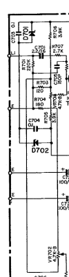

If you measure the resistance of a capacitor and it measures OL right from the beginning it is open. It sounds like you are saying C703 and C704 are open? Did you discharge them first?
I did not discharge them but the receiver has been off for about 2 days and they are small ceramic caps, but yes even if I set my MM to 2M ohms both C703 and C704 just read 0L immediately
Plz repeat the measurement then repeat but reverse the probe orientation.
Appears you are measuring path R713, D702, D701,R714, F801...
Was this measurement done with F801,,, removed?
Sorry, reverse the probes for measuring which components?
I currently have all four power supply fuses removed.
Resistance to GND??? try measuring from R713(either side)
Bottom of R713 is giving me 5.6k ohms, top is giving me 4k ohms
4.7k at bottom of R714, 3.7k at top
Both D701 and D702 show about 4k ohms on their outer ends and 0 ohms towards the middle
Same readings on everything with probes reversed

Hello, it's me again. I imagine everyone's sick of this thread by now but I have pinpointed the ground short to the top of the board just under VR701 and VR702. The ground source on the left channel side of the board comes into the top center of the board, off of which comes D701/D702, C703/C704, and R703/R704. I imagine this area of the board is for decoupling though I'm unsure. Regardless, when I remove both R703 and R704, the ground short is gone. This to me says that the zeners and caps underneath those two resistors are doing their job properly, however I don't know where you're supposed to "lose" the ground in this circuit. There are two vertical resistors (I had to draw one in on the PCB drawing as they aren't labelled well there, but on the schematic I believe these to be R705 and R706, and those two resistors on the schematic and the board itself are 3.9k) which are carrying the ground from R703 and R704 down towards my left channel output collectors. Does anyone who understands circuits know how this is actually supposed to work? Are VR701 and VR702 supposed to prevent the ground from reaching +BL?

When you remove R703 and R704, you’re essentially interfering with the operation of VR701 and VR702 that adjust the bias on the differential pair transistors, TR701, 703 and Tr702, 704 that set the DC offset voltage among other things. This is not a solution.
If a short is what you’re worried about, clear out the area of the board you’ve highlighted (after taking photos), clean the board thoroughly, test the components out of circuit, and put them back in. Then test again. I haven’t looked at this in any detail but have a feeling the issue is probably somewhere else. :dunno:
Also what @mbz stated above. It’s very unlikely that you’d have a short on both channels although I see in this circuit there are some shared lines which affect both channels.

Oh I know that pulling them isn't a fix, but it's at least somewhat telling me where the short is coming from. I had initially pulled R703, no change, so I pulled R704 and short was gone - put R703 back in, short was back. It's difficult (for me, at least) because the circuitry is so different on the left and right channels that even though I don't have the same issue on the right channel, there's really nothing to compare to. Since everything else in the area tests fine I suppose it would be an issue with VR701 and 702. I was thinking before that the ground short was causing my issues with them, but now I think it's the other way around. I've pulled the diff pairs before and they tested fine but I will go through the area again tomorrow.

Seems you’re approaching this methodically which is nice to see. I’d change those trimmer pots with new ones and test again. May very well solve your problem. :thumbsup:
Edit: Have you tested the Zener diodes D701, 702? You could at least check the voltage drop across them to see if they’re functioning. I don’t know what their voltage ratings are.

I have tested them prior and they were okay. Trim pots are new, I have them out right now and they function fine. Because their voltage was stuck when they were in, I thought that the ground short was causing that. If it's possible that it's the other way around (that the locked voltage is causing them to leak ground through to my left rail), I'm going to throw them back in and work backwards from the wipers. Unfortunately there's not many voltages to go off in that area of the schematic.
How did you test them? Please advise.
You can roughly calculate them if you know the bias currents for the Zeners. Also, it seems the schematic doesn’t show grounding for some elements (Zeners and a couple of caps), I added it in with an oversized dot below on the left. Without it, things don’t make sense. Another strange thing I noticed is that the rail voltage for the differential pairs of both channels is provided by +BL line! Why I am not sure, why isn’t BR used for the right channel? Need to check the PCB Layout. But I digress … please Ignore other marks, they’re from a different problem.
