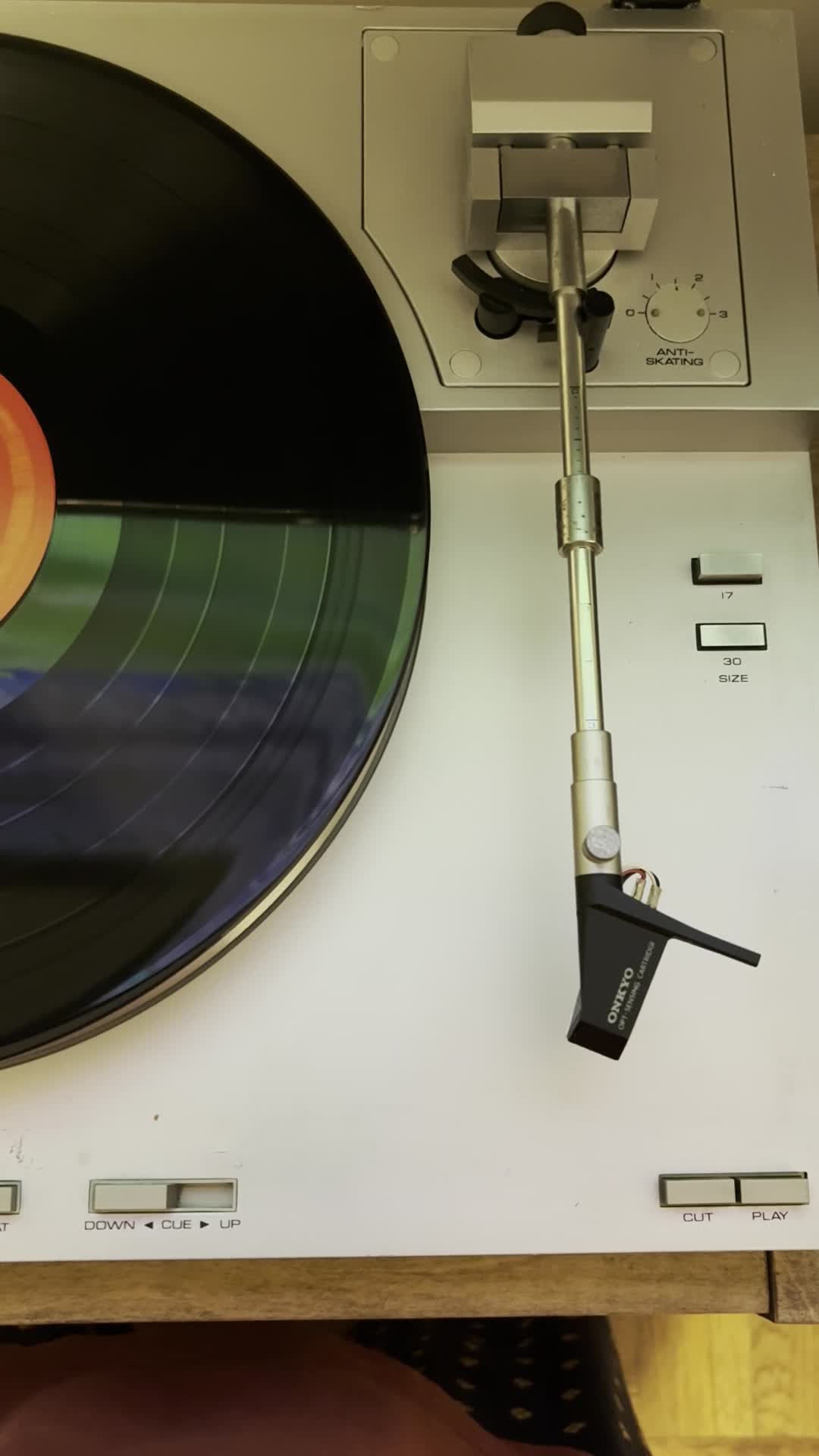

I recently encountered a problem with my P-550. I switched my cart to an AT VM95C (set overhang to 31.5mm), but then when i hit play the arm would only reach this far and slip off the record when it dropped. After switching back to the cart in the picture, it does the same thing. On 45's it is short by the same amount. Is there an adjustment for the cue-in?
Pretty sure there is a lead in adjustment. Please confirm with the manual but I believe it's by the arm pivot.
The arm lift bar also gets dirty and will affect set down a bit, sometimes causing it to shift to the side. Make sure that's clean too.
