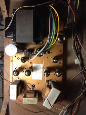

I'm trying to eliminate a 60hz hum in a 1960 Motorola console stereo. I've replaced the power caps, the rectifier, the 12AX7s, and put in a grounded plug. I will be replacing the power tubes with a matched set of EL84s in the coming months (likely the JJ EL844s), but somehow I don't expect this to fix the hum issue either.
The hum:
  • is heard immediately upon turning on the unit, with cold tubes
  • is relatively quiet, but audible throughout the room
  • is heard with the volume turned all the way down; it only amplifies at very loud levels
  • is still heard when the input from the tuner/phono is disconnected
Could this be a tube heater circuit issue? A bad power transformer? Dirty power? Mismatched power tubes?
Or is this level of hum considered normal for a system this old?
Thanks for any info or other hints!
Sounds like your transformer may be vibrating. Check that all the bolts that go through the transformer are tight. Make sure that if this is an upright transformer loosen the screws that are holding the end bells to the chassis. This is vibration and not due to the circuit since the hum starts right after you turn the amp on and the tubes have not yet warmed up. You should replace all the caps on this unit except for ceramic caps. A bad coupling cap could cause hum, and cause other damage.
A hum can be caused by many things so you need to rule out the most obvious things which were posted previously. If those solutions dont cure it try pulling the driver tube/tubes and see if the hum goes away. If there then the hum is probably in the power tube or power supply circuit. If hum goes away then check the drivers for problems like cold solder joint, intermittent short, poor contact with tube pins, etc. good luck

I can feel the power transformer jolt when the power is first turned on, but I can find no mechanical vibration after that, either by touch or by listening in with a mechanic's stethoscope. The old rectifier did have an audible rattle; perhaps there is magnetic induction from the transformer?

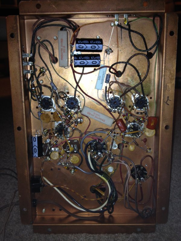

I replaced all the old electrolytic caps, including the coupling caps. I left the old power can in, though it is not connected anywhere other than to the chassis ground. There are still a few electrolytics to be replaced in the tuner/preamp, as well as the crossovers in the speakers, but I don't think these would be the source of my hum.

Your Main filter cap replacements look ok for Sections C15D, C15C, C15A. However C15B looks like you just connected the new cap to the old cap's POS terminal. In which case if that section in the can was bad and causing the hum, it would still hum if bypassed with another cap. ISOLATE the POSITIVE Terminal of the new cap with all the resistors, caps, and wire leads FROM that CAN CAP section.

Thanks for such a close look! It isn't very clear in the photo, but that C15B is actually connected to a terminal strip mounted on one of the can tabs; the old can is not connected in any way other than the tabs to the chassis. Even so, I'm tempted to take the old can out entirely just to be sure.
