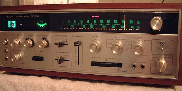

IMHO ... One of the best looking receivers ever built.
Granted, not one of the stronger amps - only rated at 27w x4 per channel - but keep in mind, these are old school watts, and better yet, old school SANSUI watts. Extremely conservative in their ratings. I've had several over the years and always liked the clean rich sound. Although the channel processing is considered primitive compared to the TOTL QRX quads (no SQ, CD04, Dolby), that can actually work FOR you when synthing from a stereo source. The I/O is just short of spectacular. There's really nothing you can't hook up to the thing, and the speaker selection is outstanding. Two sets of four, four sets of two, and you can run any two as well as reverse, twirl, and maybe even turn them upside down while you're at it. The pre out/amp in loop is indispensable for outboard processing.
But I digress.

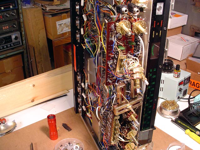

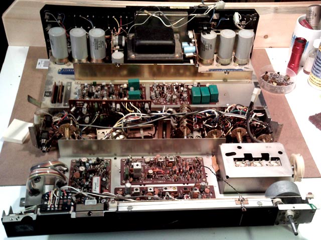

I'll be doing a rebuild on this one while I gather information (and the courage) to tackle a QRX9001. Something tells me I'll need the practice.
So here we are so far.

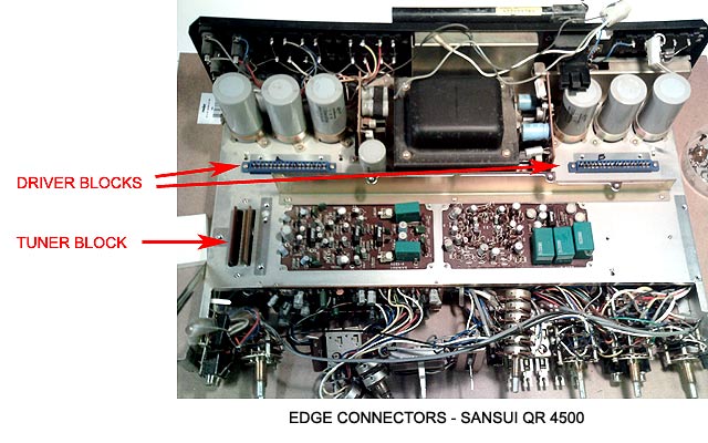

- Front panel removed.
- Driver blocks (F1180E x2) removed. Those are slip in cards with edge connectors. Good just to get those out of the way and stashed in a safe place for now.
- Heat sink/power transistor assembly moved back to allow better access to power boards. Removing it entirely would require quite a bit of extra work you really don't have to do. That extra inch makes a big difference later on when you tackle the power boards. I <may> decide to remount the transistors with new insulators and heat sink compound as the old stuff wasn't all that good to begin with. Heat is the killer, so ... head it off at the pass.
- Tuner section removed. This is a neat feature that should be mandatory on ALL receivers. Eleven screws, pop the main I/O connection, slip off the antenna leads, and the whole shebang lifts off. Don't have to mess with dial strings, and clears access to the lower tier of boards. The tuner section will remain untouched, other than general cleaning of the boards and connectors. Tuner alignment is best left to the professionals, as any change to the original components WILL require a full realignment. Unless you've got drift or other known issues, best to just leave it alone. A bit of Fader Lube to restore the original spin to the magic wheel, and some Pro Gold to restore all the contact surfaces should do it.
Some of the modular features on these things take a lot of the work out of it. 70s tech wasn't all bad.
One thing I will have to do is re-point all the solder connections on the light board. Those tend to go open or intermittent over time due to all the heating cycles. I'll also replace all the fuse lights while I'm at it. The old ones work, but ... famous last words there.
Not bad for a days work.

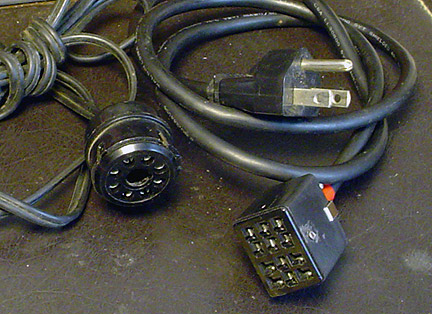

Missing power cord
Looks real clean - then again, the bottoms always do. We wanna see the top!
The breakaway cord was to allow swapping in whatever you needed wherever you happened to be without having to use an external adapter. Problem being, they had a way of getting away from you. Somewhere there's a whole mountain of old power cords - probably right next to the mountain of lost socks. Not sure where those things go to. Maybe somebody on the board has a spare. I've got a couple - and no, you can't have em,said the packrat in me. <G>
At least these are easy - compared to a lot of power cords. Here's a couple head scratchers in my collection:
A true audio restoration purist would make a wax mold of the socket, modify crimp on slip connectors for an exact fit to the posts, then make a replica connector from PlastiFix using archive photos of the original, molding that directly to the new cord. Goes without saying, they'd also look high and low for a RED cord to match the original. These are the same people who spend months looking for a bolt with the exact markings and specs for their '55 Corvette.

If it were me, I'd just lop off one end of a good flat wire extension cord and use that. Easy access to the original plug socket. Desolder the wires inside to the power connector, then remove the connector and make a simple plate to fill the hole. put a hole in the new plate big enough for a strain relief grommet, then solder the wires and you're done. Just make sure you attach the wide blade side of the plug to the white wire to keep the phasing correct.
All that of course assUmes access to some basic tools.

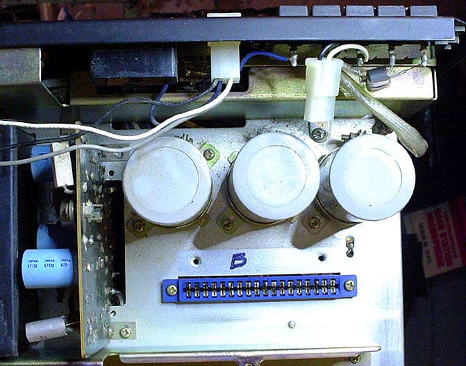

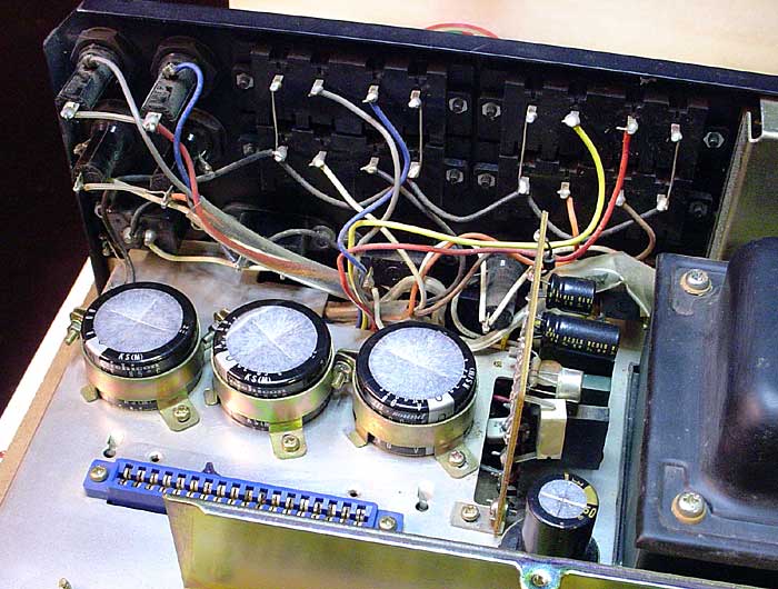

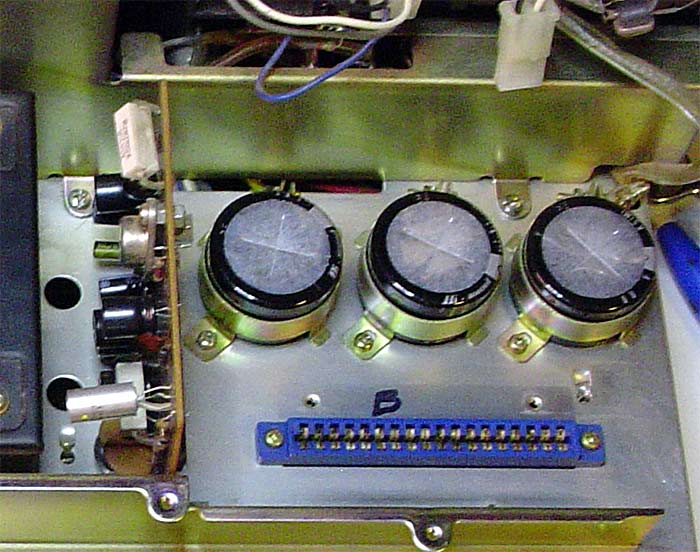

Left power block done
Including the F1360 board. Once again, I was able to pull that up from the chassis just enough to get at the caps. Only two electrolytics on the board, but a bit hard to get to. Easier if you remove the large primary cap behind it, then the bracket screw to the chassis on the back, and the bracket screw to the board on the front. You can get extra slack on the wires by taking them out of the guide strap underneath, then wiggle it up and out a bit.
Also replaced the primaries on that side. Notice any difference?
I'm thinking a whole lot more air flow. <G>
Amazing the difference in size on the components from then to now. The shorties are exact matches to the original spec. I usually like to go with the 30% rule and increase the ùf value on the primaries, but nothing in that range was available. I was able to find the same diameter, so the OEM clamps work nicely. Not so lucky on the 100ùf 75v next to the transformer. Closest I could come was a 100ùf 100v. Close enough. I just gooped the bottom of the cap with rope caulk like they use on car windshields and jammed that into the OEM clamp. Works nice. Here's a closeup of that:
Put it back together, fired it up - sounds good - no smoke.
NEXT!

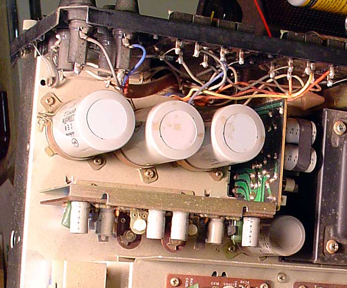

And now the right power block is done
About three hours worth of work, and yet again, NO SMOKE! :thmbsp:
Before, including the F1362 board located to the right of the transformer viewed from the front of the chassis. That also had enough slack to do the work without having to mess with the wiring loom. You'll want to pay attention to the orientation of C014 and C017 as the board markings are ... ambiguous. My old trick of marking the side of all the caps facing me prior to removing them paid off as I was able to eyeball the correct polarity.
After:
Oh. Here's a view from the bottom.

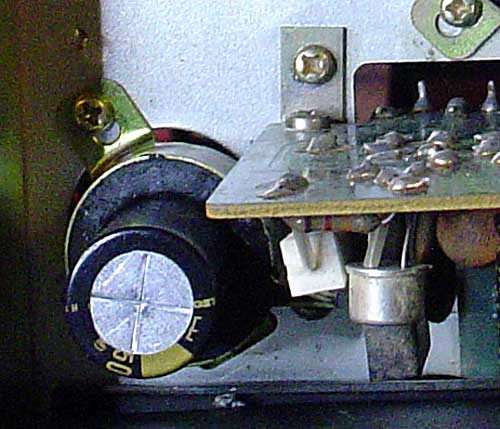

Don't forget the cap dangling off the bottom of the F1362 board. Looks like they worked themselves into a corner for C011. There's a spot for it printed and drilled on the board, but that's left empty. Surprised they didn't just add a bridge, but hey, that's why they call them inscrutable. :D

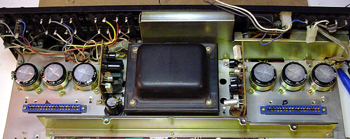

And the completed power bank:
Once again, put it back together, fired it up, and it's good to go. Can't really calibrate it till I get the driver boards done, so I just ran it at low power enough to see if anything went <pOp> ... Nothing went <pOp>, so ...
NEXT!

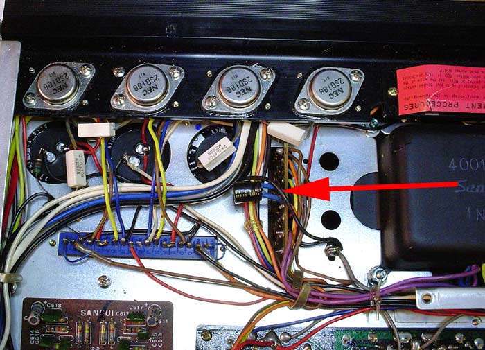

psssst ... got it covered. That's kind of a Where's Waldo thing ... I know it's in here somewhere ...
Ah. There it is!!
I guess I did forget to mention that.

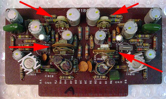

Still not gonna run it up to full load until I get the driver boards done. That's where you do the current and output adjustments.
No faults (as in smoke or exploding light bulbs) showing, so not much sense doing that until it's done. I did notice one thing that bothers me ... the paired drivers at the bottom center of each board ... well, for want of a more technical term ... look like crap. They work, but whatever passed for heat sink compound back then turned to some nasty looking sludge. Anyway, I did find out that the heat sink is just pressed tight to the cans. I was able to pry one off with some needle nose pliers and an Xacto knife. Here's one removed - the right side is loose, so it's a repeatable tweak.
Doesn't look like there's any real damage to the cans. I'll scrape and polish a bit (not too seriously - the transistors both look to be unobtanium grade), clean the copper heat sink and press them back with Arctic Silver. That should do wonders for heat transfer and keep them cozy for another 30 years.
<edit>
Looks like those paired transistors aren't as unobtanium as I thought. Did some more digging, and NTE cross-references them to a NTE129MCP matched pair. $18 will do both boards. Hmmmmmm ...

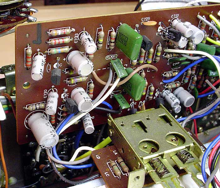

Film caps to replace small value electrolytics?
Having problems finding replacement caps for some of the low voltage electrolytics on the synthesizer boards.
1.5µF @15v
3.3µF @25v
Can I replace these with film caps in the same values? Those are rated at 250vdc, but are NOT polarized. Size shouldn't be a problem. I know substituting bi-polar isn't wise, but ... not sure about this. Only other issue I've seen is maybe additional crosstalk in the circuit due to the fact that they're not shielded. Heck ... if that's a problem, a quick wrap with foil duct tape should take care of that.
There's also a boatload of 1µF and other such small values that might benefit from the additional stability a film cap could bring.
