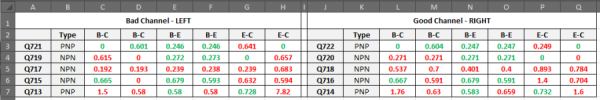

I tested all of the transistors on Diode test . tested Base and collector on each . found both channels very close. Not sure if thats good enough or if i have to do 6 way test on each transistor, Or if i should just check all voltages.
After testing the P700 left amp this is what seems amiss, I tested resistors both way and the numbers i list were quite different left to right then right to left
R705 R713 R715 R727 R803 R831
I compared transistors doing 6 way test and found these to be far off from right amp
Q713 Q715 Q717 Q718 Q721

Im listing the resistors with first number left to right, second number right to left
R705=50k, 43k R727= .825M , 30K R803= 53k, 71k R831= 7.6k , 5.0 k
All other resistors showed virtually the same number both ways.

That's OK, but did they compare close to what is on the schematic?
R705=50k, 43k R727= .825M, 30K R803= 53k, 71k R831= 7.6k , 5.0 k
I would lift one end of these two (or all 4 resistors if you want) and recheck resistance.

What were the values you measured? It doesn't help if you don't list what you measured.
Q721= red BC=0 BE=.246 EC=.641 black BC=.601 BE=.246 EC=0
Q720= red BC=.271 BE=.271 EC=0 black BC= .271 BE=.271 EC= 0
Q719 = red BC=.615 BE= .272 EC= 0 Black BC= 0 BE=.273 EC= .657
Q722= red BC=0 BE=.247 EC= .249 black BC=.604 BE= .247 EC=0
Q717= red BC=.192 BE=.239 EC=.239 black BC=.193 BE= .238 EC=.683
Q718= red BC=.537 BE=.401 EC=.893 black BC=.700 BE=.400 EC=.784
Q715= red BC=.665 BE=.679 EC=.632 black BC=0 BE=.593 EC=.594
Q714= red BC=1.76 BE=.583 EC=.732 black BC=.630 BE=.651 EC=1.60
Q713= red BC=1.50 BE=.580 EC=.728 black BC=.580 BE=.580 EC=.728
Q716= red BC=.667 BE=.679 EC=1.4 Black BC=.591 BE=.591 EC=.704.

What does red and black mean here? I assume it is the color of the DMM lead.
What you should be doing when measuring a transistor junction is:
  • measuring base to emitter junction,
  • red to base, black to emitter, read voltage
  • black to base, red to emitter, read voltage
I don't know how to interpret your measurements above.
Were these in-circuit measurements?
If you used your Fluke 115, then it should not read 0, but OL for a reverse bias diode (transistor junction). Otherwise it may mean it's shorted.

How testing was done and how to read results
On each transistor this was the order , Red lead on Base, black on Emitter. then Red on base, Black on collector .then Red on emitter Black on collector then i reverse
Black on base, Red on Emitter. then Black on base, Red on collector. then Black on emitter Red on collector. Then i would test what i believed was the matching transistor from the other side, this is why i listed them to confirm i have the correct transistor. Most of the transistors from side to side where reversed, i made sure i was always testing each transistor in the same manor. Base, Emitter and Collector was marked on board so easy to follow.
As for the 0, it meant OL . you wouldnt know this but if i had 0 voltage i would have marked it 0 vl . my bad.
If you would like them tested differently i will gladly do it. All other transistors matched or almost matched their counterparts, these were the only ones different.

Your description of the order of test does not match your measurements??
Please clarify the order of testing. Your first line in your response says "this was the order", but if you look at post #1012 it is in a different order. Just want to make sure you noted the leads correctly.

Base collector, then Base Emitter, then Emitter collector then reverse leads and measure the same. these are the measurements you see. in my post 1012
The reason I ask is that measurement order on your list of measurements does not match the description you just provided.
For example:
You said ... this was the order...Red lead on Base, black on Emitter
But your list of values show... Q721= red BC=0 BE=.246 EC=.641 black BC=.601 BE=.246 EC=0 (red on base, black on collector?) or should this be BE?
Understand what I am saying? Is this description incorrect "As I described is exactly how I tested." or is your measured list incorrect, or did you write it out of order?
Just trying to make sure I get the right values before I dig into it.

It must be something I'm not making clear
The numbers on 1012 came this way.
Red lead on base, black on collector
Red on base ,black on emitter
Red on collector,black on emitter
Black on base red on collector
Black on base red on emitter
Black on collector red on emitter
Thank you for clarifying that, it's just that you then stated on post #1015 that is a different order, testing the base to emitter first, NOT base to collector. If you didn't make this statement, I would understand but this is different than the order of your measurements.
And, yes you are not clear because you have two different measurement orders stated.
For now, I will assume that the table is correct and your description below is incorrect. OK?
