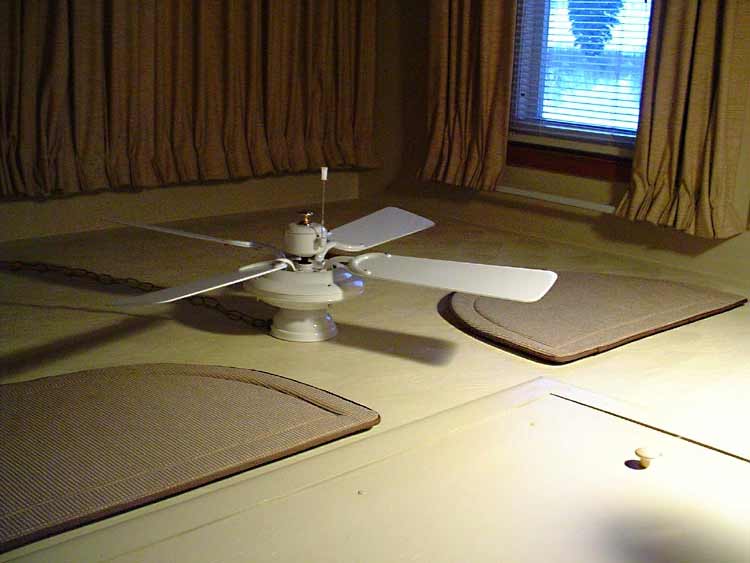

My biggest problem was ceiling reflections. I fixed that by tacking some memory foam carpets to the primary reflection points ...
They really kill the shrill. I've since been able to use a few driver tubes that would have cracked plaster before adding them.
And it's fun telling people to wipe their feet when they come in ... and pointing up ...
Also went with full length insulated fiberglass curtains on the back wall. That got rid of the bass bounce and a mean peak at 160hz.

How did you get them up there? Any trouble with them falling down?
Gravity!
There it got interesting. I used some of those Command picture strips, but they kept separating from the carpets. Ended up stitching those on and no problems since.
The have sagged a bit in the middle over the year they've been up there, but that's more in keeping with the 3D motif of the thread, right? <G>
Price was right ... I think I paid $8 each at the local big box.
