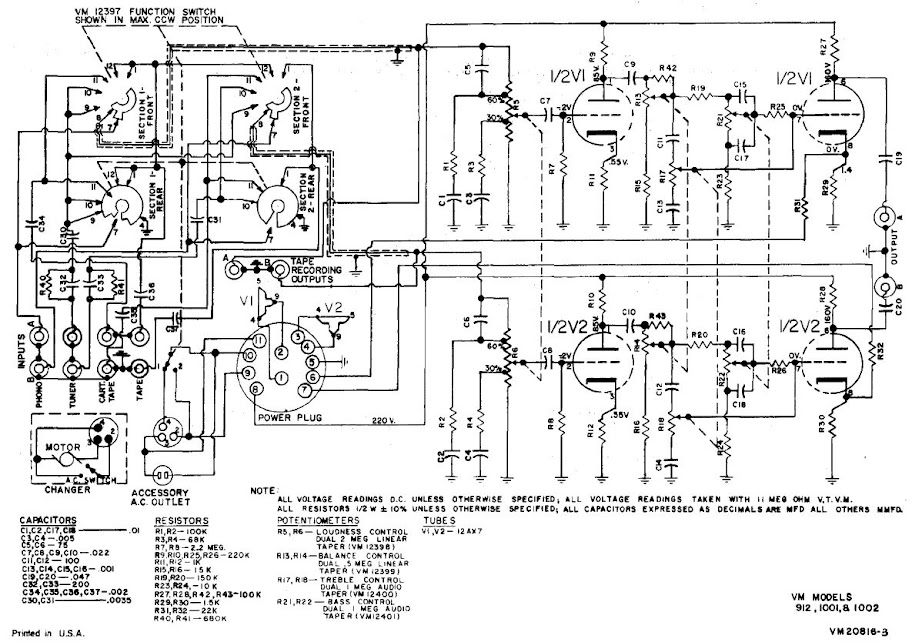

Does this amp call for two 4 Ohm speakers pr channel or a total of 4 Ohm pr channel?

Well the schematic shows the output transformers as 4Ω output so one 4Ω speaker only per channel.
You would have to know to use two 8Ω speakers connected to both the internal & external connections so it would be a 4Ω load. The manual would also hopefully say so.
What he said. 4 ohms total, internal and external were likely 8 ohm each.
Looks like its missing an amplifier stage. This is only a phase inverter per channel, usually you need a phase inverter and a gain stage along with the output tubes.

Some folks are saying that because of the open Ground, "the amp accepts 2 "4 Ohm loads pr channel". Getting mixed answers.

The internal speakers are at 4 Ohms.
not sure what they mean by open ground. Its very clearly grounded on the speaker secondary, which it has to be for a global feedback amp.
Either way, it seems fairly clear to me that its a 10K primary and a 4 ohm secondary based on what the schematic has printed on it.
Thank You. So two pair of 8 Ohm or one pair of 4 Ohm pr channel?

Really appreciate everyone's help. Still having trouble understanding this.
The unit come stock with 2 internal speakers and 2 external speakers. I do not have the external speakers, but do have the internal speakers.
Where it gets confusing is the internal speakers are reading @ 4 Ohms.
Some people and saying that the amp is designed to operate with 1 or 2 pair of 4 Ohm speakers, kinda like some fender amp designs.
Stuck in limbo and unable to begin a speaker system build.
If this is a Voice of Music Amp, the best guy who'd probably know is Gary Stork @ www.voiceofmusic.com I'd run it as is with the one set of speakers and not worry about external's. it's possible that there is a switch that isn't shown to switch between the two speaker pairs. Look for an Internal/external spkr switch in the back or on the control panel.
