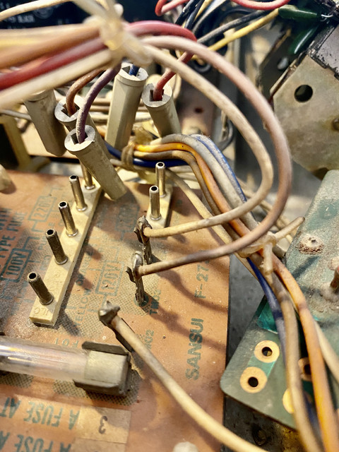

I will start working on the Power Amp Board F-2754, I am wondering if I should completely remove it from the chassis or if I should try to work on it with all the wires still connected.
I am actually worried about making mistakes reconnecting all the wires!
On the other hand, the board is so dirty, it will greatly benefit from a deep cleaning.

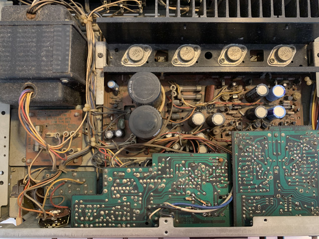

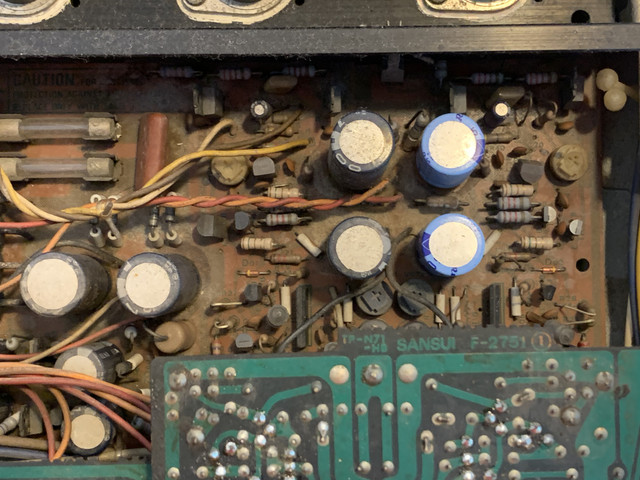

Take photographs and document the order you do things in. Label bags for screws etc. I would remove the board, much easier to work on. Sansui boards are well labeled but there have been mistakes at times. Get a large bottle of isopropyl alcohol, you'll certainly need it with all that crud. I would start with an air compressor & blow out as much as possible. I can see one of the large caps is swollen, possibly been stressed so I would not reconnect the power supply to the rest of the amp, test the voltages first. If it checks out then move onto the next board. I would not reconnect power until checking output and drive transistors, diodes etc on all the boards looking for shorts. A semiconductor checker is a very handy tool. I'd highly recommend a Peak Atlas DCA55. It will really help you. Lots of help on this forum so always ask.

today, I worked on my shopping list!
I focus first on the Power supply, regulators, and protection sections
Mouser project:
https://my.mouser.com/ProjectManage...jectGUID=6cb715b6-2649-446b-9c37-56a997d922dd
I understood that for the PSU it is possible and advisable to increase a little bit the capacitance.
I mainly followed @Karl vd Berg 2017 list, and I played around a little bit in order to get available items.
As you can see it is mainly Panasonic FR.

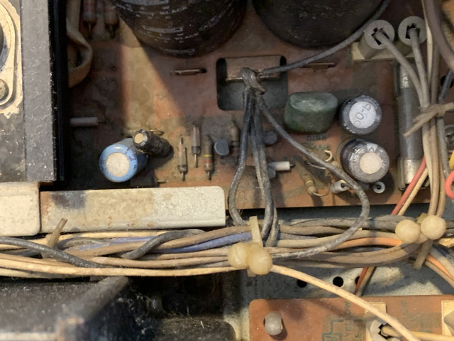

regarding the C602 and C615, i noticed that no one changed them, what is the reason?
Do you recommend me to change the diodes as well?
  • D602~D605
  • D601, D606~D609, D610
  • ZD601, ZD602
That's a good list. I know it is quite common for people to increase the value of power supply capacitors thinking it will help the amp but it actually has the opposite effect. The rule is generally to increase the voltage but not the capacitance. Higher capacitance puts a strain on the power supply at start up and can result in premature failure of diodes and regulators. You will be drawing higher current to charge the capacitors unless you modify the circuit and install a slow startup feature. You could go up a small amount to 12000uf but the jump to 15000uf is a 50% increase, I would not do that. The important thing with these 2 caps is the physical size, they are big for a reason, do not put in physically smaller capacitors that's okay elsewhere but not the main filter capacitors. Diodes are up to you depending on if they have failed or not. I would generally replace the zeners but not the rectifier diodes unless there is visible damage from heat or corrosion. Watch out for corrosion on other components like resistors from the terrible glue they used on the capacitors. I would check all the resistors to make sure they are within tolerance. There is no need to change C602 and C615, these will last forever. I usually do not change greencap or ceramic capacitors unless they have obviously failed, these are super reliable and long life. The diode to change is D01, D02 VD1212 on the Equalizer board, these fail.

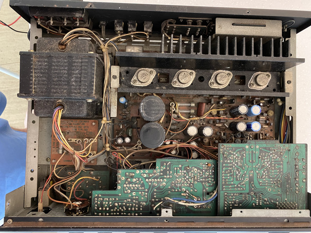

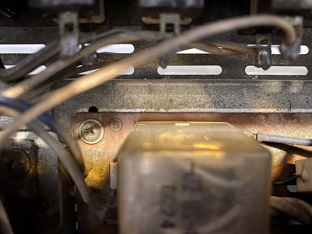

I noticed that my AU-317 is a revision B:
I am assuming the Schematics will be a little different.

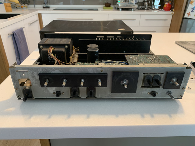

I started the process of removing all the boards.
so dirty !
time to desolder the wires...
I will take a lot of pictures and I will try to rely on the schematics, but still, I am a bit afraid of not being able to re-wire everything correctly in the future.
Any great advice?
Are you labeling all the wires?

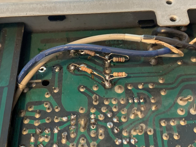

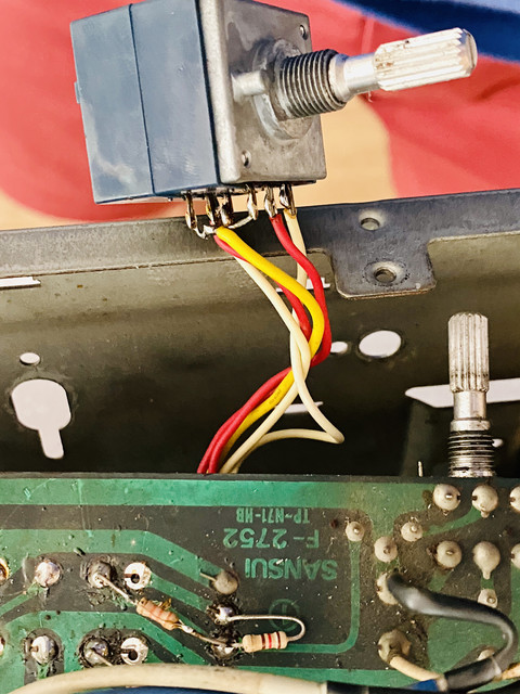

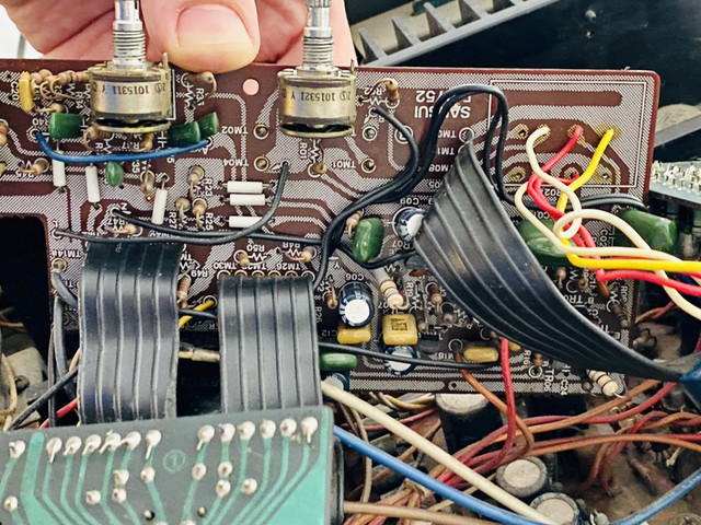

Hi,
re the resistors mounted on the rear side of the tone control board, this is not a factory mod, there looks like there has been other work done on that board as there are quite a few solder joints that look suspect, and the insulation on many of the wires going to the board have been touched by a soldering iron. now that the component side of the tone control board cab be seen in the pot above, it is as I originally suspected. The volume pot has been replaced and it doesn’t have a loudness tap, hence the added resistors on the back of the board (possibly trying to mimic a loudness tap function). Is there any part number or markings on the volume pot that is fitted?
Cheers
John
