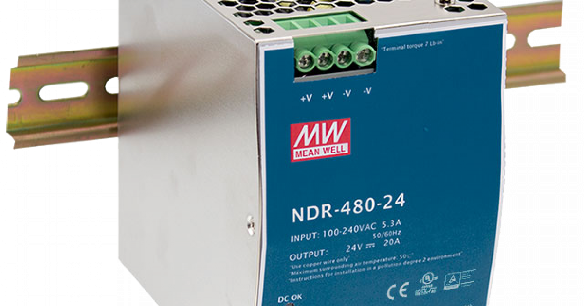

a few lingering ideas about a txf delete mod will be sitting on the shelf. installing a pair of 48v din rail mount smps in series plus low velocity active cooling is something to think about, plenty of space. it would reduce chassis weight by more than a little.
difficult part might be if both supply's dont activate at the same time. perhaps a double rail activation/protection circuit would be optimal downstream. also change the power cap values plus reduce overall ripple with a crc design.
