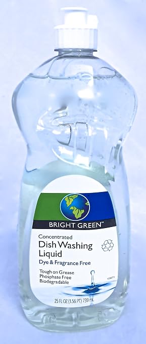

Common practice is to use a "Drop" or two of common hand dish soap.
Correct... a drop or two in a gal distilled water
I use (below)... one bottle lasts forever
