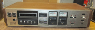

The Wollensak 8075 is, arguably, the best 8 track player/recorder ever made. It eclipses most other 8 track players in about every way.
30hz-15Khz with the special tape formulation, 30-12Khz with "regular tape". 0.1 Wow and flutter spec, better than 50 DB SNR with Dolby off, can achieve better than 60Db with Dolby on. 1v line out and it goes on and on.
Now, those would be pedestrian numbers for other media formats/players, but for 8 track, well...top o' the heap. The Wollensak 8075 is as good as it gets for 8 track.
I periodically would check the online auction sites, but nothing ever showed up and if any Wollensak product surfaces, the asking price is always on the ludicrous side of "high".
But this evening, I typed Wollensak into ebay and an 8075 popped up. Couldn't believe one was there. Opened the page and 99 bucks USD plus shipping. Works out to a 310 CAD after exchange and paypal's little bite. I fully expect to get dinged at the border by Customs as well. That's just a part of doing business cross border.
What? This can't be.
Looked closer and the standard "for parts or repair" is there. Nothing surprising wit 8 track players. Says ape doesn't run, but "goo-ified" belts are not an uncommon thing from 1974. Worst case it's a motor gone bad. All things I can deal with.
Two switch levers are broken off, but again; nothing I can't fix easily enough.
The face plate is relatively unmolested and the rest all seems to be there, so no rare bits and piece to hunt for.
The wooden case is, well....."distressed". No big deal as I'll just make another if I need to.
So yeah, I'm ind of stoked! Still "only 8 track, but the 8075 is, for all intents and purposes, the high water mark.

Pics from the auction:

Got my Wolly!
Canpar dropped it off about 10 mins ago and that's fresh out of the box.
Currently letting it come up to temperature and sit for an hour or two to allow any condensation to flash off.
Labeling is in better shape than the auction pics showed. There's one spot on the line that makes the box around the Dolby/tape switches, but easily fixed. Faceplate is in good shape other than a little nick or rub here and there. All things I can easily fix.
New belts are already on the way and I've got a stock order of 458 transistor replacements on the way in case there's any lurking in the bowels of the Wolley.
Wooden case is kinda beat up, but I knew that going in.
Initial look at the heads reveals they are very clean and appear to have little to no wear.
Capstan looks good, at least pretty clean. It does have a shiny spot, but all 8 track players get that look after a couple tapes have been played.
Couple broken switch levers, but knew that going in as well.
Overall, it looks like someone took care of the innards by at least keeping the head and capstan relatively in good shape. I'd say it got minimal use after it left their care and probably the next few owners neglected it and beat up the exterior a bit.
Should be a fun restoration and will be interesting to see how the TOTL Wolley compares to my Superscope TDR-830.
And my "minty" Akai 4000DS shoudl arrive today too.
Quite happy right now!
Up to temp and plug the wolly in. Fire it up and you can hear the motor whirring rather loudly. It's noisy enough that I'm thinking it might be toast. I pop a garbage tape in and...nothing. Doesn't run.
Pop he case off and sure enough: the belt has broken. I dig around and find one that's pretty close, a little on the tight side. But it will work well enough for testing purposes
Try a tape again and yep, it runs!
It needs the deoxit in the usual spots and responds well to it.
The preamps are unbalanced now that the VR's have been freshly "deoxited", so a little twiddling brings then back to even output.
Notice the tape counter isn't running. Closer inspection reveals the shaft plastic gear has split. But it's split because the worn gear was trying to drive it against the shaft, which is locked up solid. Disassemble, clean and lubricate and the shaft turns freely again. The dials with the "0" is a little messed up, someone was obviously trying to force it to turn and scratched them up. I can fix that later with a little careful pin-striping level work.
A quick survey of my idle audio gear and a google search reveals I'm not getting a replacement gear anytime soon. So time to get creative.
I mic the plastic gear's shaft and select a precision mini drill the same diameter. The I superglue the crack and force it together with a pair of precision pliers on adjacent teeth. Once cured, I run the drill though the gear hole in a pin vise. The gear now slides on and off it's shaft without trying to split the gear at the glued joint. The worm gear still catches on the joint, but a little careful reworking of the area gets it running nice and smooth again.
But now h gear just spins on it's shaft. Easy fix, a little loctitie blue and the tape counter works a treat again. Nice and smooth.
About this time I start noticing "cross talk" after the program changes. I adjust the head height to eliminate it, but it comes back on the next program change. OK, so the head assembly will need to come apart to be cleaned and re-greased. Easy job.
But just then I notice the motor is getting a lot of WOW and beginning to slow. Oh oh. That's fairly known issue with some of the motors where they go that way when they warm up. These motors are hard to source replacements for too. Figuring I have nothing to loose, I pull the motor and start tearing it down. Bronze en bearings are as dry as a popcorn fart, so i soak them in synth bearing oil. The brushes and commutator look a little dirty, so I clean them up. The governor chamber looks brand new, so i clean the grease on the end cap, give it a fresh daub and put it all back together.
Back in and power it up. Motor is running strong. It REALLY fits against my hand when I try to drag it down, which it didn't do before. So I pop a tape in and....yeah. Now it's running too fast.
It's not "alvin and he chipmunks" fast, but it's still too fast. maybe half a chipmunk fast.
So I must have disturbed something in the motor governor despite how careful I though I was. Good news is the motor isn't toast. Bad news is I'll probably have to go back into the motor to fix it. Have to read the service manual again before I do that though. If there's a speed adjust on the boards, I'd rather do that first.
But that's enough for today. Time to put it aside for tonight and back on to it tomorrow.
Ah ha! The service manual reveals there is a VR for motor speed!
Stolen pic from the internet:
I give it a good soak in Deoxit for good measure and function it many, many times from low to high adjust. Back to where it started, fire up a tape and half a chipmunk again. A little fiddling and it's running just about right.
So now the motor is running strong as and ox and speed is easily adjustable.
This old hack is coming together nicely. It's not even really fighting me that much. I think it wants to live.
I have noticed the capstan will stall out and slip on tapes quite often. Looks like it's a candidate for my "sandblasting" process to restore it's "grip".
On to the capstan and cross talk/head height issues tomorrow.
Well, I'm going to call the motor good to go. Just let three carts run back to back though the machine. No WOW and no speed drops. Motor isn't even warm.
Guess the motor just wanted a little care, cleaning and attention.
This old Wolly wants to live again, I can feel it......;)
