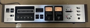

I thought you might be interested to know that I did get mine last night. It is in fact in very nice cosmetic condition. I plugged it into the Dbt didn’t get a short, so I plugged it into mains. The motor seems fine yay! I replaced the belts, they were still intact, but slack. It sounds very nice on one channel. The other is out. All the program lamps are out.I need to deoxit the switches. I’m gonna need to put it away at the moment though. I’m replacing the soffit and gutters on my house and I’m building a curve tracer so I have my hands full. this is gonna set aside for a little bit until I can get to it.

A pic or two wouldn't go amiss.....;)
Top photo is on my bench, bottom photo is from the listing. That’s just a bit of tape on the right meter.
Cool. Welcome to the pinnacle of 8 track development....which is sort of a "tongue in cheek" thing.
You just gotta get it sorted out now.
The Wollensak is generally considered "better" than the Akai's, but only by a marginal amount. The only place the Wolly isn't considered "better" than the akai's is with regards to the motor. The Akai's use (so I've read) a fairly large AC motor. The Wollensak's use a DC motor that has been reported to be a bit on the weak side and somewhat failure prone.
The Ac motors are freq locked to the mains and require pulley changes to affect speed corrections, the DC motor in the Wolly is adjustable by a VR pot. If an Akai is running slow and it's not the belt or a leaking run/start capacitor, it's the motor itself. If The wolley runs slow (or fast) a twiddle on the vr may bring it back in.
Which is actually "better" is kind of a worthless argument with everything over 40 years old by now. In theory, the AC motor should be better (torque) and should stand up to aging better than a DC motor with it's commutator brushes that wear with use.
My Wolley 8075 was exhibiting motor issues that seems to be typical of them as they age. That was until I took it apart, cleaned the internals and soaked the bronze end bushings in oil. Now, it runs strong enough to fight my hand trying to slow it down. I suspect a lot of Wollensak DC motors that were condemned were actually just in need of a servicing, something that a lot of people just don't want to do because everything inside a motor case is on the order of "black magic" to them. The Wolley motor is even more "black magic" because it has a speed sensing section on the back of it too. I believe it varies the torque according to load sensing, which is why it "fights back" when I try to slow it down by grabbing the pulley.
Then there's the general specs of both. The 8075 has it over the CR-81d pretty much everywhere other than 15 khz vs 16 khz. But it's all pretty close and in practice, probably not even noticeable. I'd be pretty skeptical if someone said they can hear that 1 khz difference, even more so if they're over 50 years old. Which, frankly, captures virtually all of the demographic that still fool around with 8 tracks these days.
