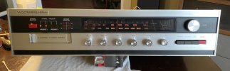

An 8 track player I'd never thought I'd own
Nice unit, I haven’t had an 8-track in a long time. If you’re gonna have an 8-track, it might as well be one of the best ones; yours looks substantial.

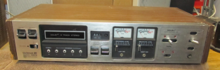

First replacement lever made:
Test fit:
Excellent.
It works the switch mechanism fine even before the application of the epoxy to fix it in place.
I did go a little “overboard” on easing the edge over, but I’m not sure I want to bother with making another to replace that one. I think you’d have to be looking pretty close to even notice.
2 more to go….:)
All done:
Looks pretty damned good if I do say so myself!
Especially considering how it looked when I started:
next up is to blast the capstan and then back into the case. I think I'm just going to black woodgrain vinyl wrap the case for now. Like on the 8080DB:
It's quick and easy way to clean up the looks until I decide what to do with it and have the time to do it right.
So on to the finishing bits. Pulled the belts and then capstan. Out to the shop and a quick "sandblast" to restore the finish. All cleaned up post blast and a little cleaning up of the flywheel belt surface. Just a light sanding with 1200 grit to remove some roughness in spots. Not removing any material, just knocking down the roughness (IE: wow and flutter). Then back together it all goes.
I also learned long ago that RCA jacks on vintage gear is just a hum/buzz waiting to happen. No matter how much you clean them, there's always some corrosion/tarnish/schmutz in there waiting to get you chasing your tail looking for "system noise". So now I just yank 'em for new. The 8075 gets the same treatment:
It's so easy to do on the Wolly, it's almost like they planned for them to be replaced at some point.
That done, its on to the case itself. Nothing extravagant, I'm just going to vinyl wrap it for now. I'm just looking to get it to "respectable" appearance wise. first use a little spot filler to fill some damage and build up some beat corners:
with that all cleaned up, apply the first piece of black woodgrain vinyl and trim to fit:
That's the easy piece. The ends take a bit more thinking and fitting/trimming:
With that done, back into the house and refit the main unit to the box:
You'll notice a bubble" here and there at corners. This vinyl needs to relax a bit before the adhesive will hold properly. In an hour or so I'll smooth them out and they will stick in place.
Is it perfect?
Well, no. It's not.
Is it perfectly respectable?
Well yes, yes it is. It will look even more so once it's on the shelf in the cabinet where most of the case will never been seen.
I'll probably do something nicer for a case in the future, but I've just had enough of it for now and it's time to let it spool tape!

Ah, so it appears that the left drop out is a head travel alignment issue.
Some tracks play fine, some drop the left channel and still getting faint cross talk (which I thought might just be some print through). Seems fairly consistent that program four drops the left channel, which sort of points me toward sticking head travel.
Too late tonight to so any more. So tomorrow I’ll get back into it and strip, clean, lubricate and realign the head mechanism and see what I get.
Oh yeah, the head is off for sure.
I can play program 1 first song on the TDR-830, pull the cart and put it in the Wollensak and set to program 4 it plays program 1 first song but drops the left channel.
That head is waaaaaay out.
At least thats an easy fix. Also explains the odd cross-talk effect I was getting on the Wollensak.

Aha! Turns out I’ve been “rope a doped” by some previous owner/tech.
What they had done is rotate the program indicator to light up for what they thought was the right track.
The Wolley has enough head adjustment to go fully to the program on either side of the program that should be playing. But when you do that, it will miss either a left or right channel.
So they adjusted for what they thought was the correct head alignment.
Turns out it was not.
I found it by selecting a track, then adjusting head hieght to both extremes. Of the three programs you could adjust it to, only the middle program plays both channels properly. The upper and lower adjustments all drop either the left of right channel because they won’t align with the head sensors properly.
So I adjusted for mid range travel (IE: the proper track) and both channels play perfectly on all four programs. The program indicator light is off by one program now, but that’s a simple set screw and turn the light switch back to where it should be.
Vintage audio: ya never know what yer gonna get!
