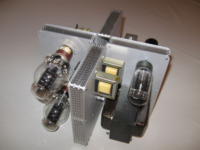

IMG_1284.JPG IMG_1285.JPG Greetings--as mentioned before, the X3 will hum noticeably on startup, and then become very quiet after just a few seconds. On my Proac 1.5 or Tablette this is no problem; since on Gantray's amp the hum returns that would need to be checked. Regarding the hum pot knob, my X3 did not have one when I bought it; the knob shown is an old brass Dynaco knob I had and put on just for show.
Now a question for all the tube experts here (I only pretend)--in addition to the output transformers, the main power trans, and the filter
chokes, the X3 has three others. On the Cerafine panel is a filament transformer, a Magnetek F5 120 (power transformer?), and another large transformer. The filament thing is obvious, but the others??
[Regarding the hum pot knob, my X3 did not have one when I bought it; the knob shown is an old brass Dynaco knob I had and put on just for show.
Well that settles why this X3 didn't come with the knob. Garber never put on one in the first place. What's the rectifier tube you're running, btw? Is that the Sovtek 5AR4/GZ34?
As for the component identification, the way he's using transformers compared to the more simple 2A3 topology is one of the biggest reasons why I'm looking for a schematic.
The amp was shipped in 99 with period EH 300b, average quality, two JAN Phillips 6sn7, and a Sovtek rectifier, which arced in a week. I replaced it with an old Dynaco branded Mullard harvested from a ST70, still testing and sounding as new nearly 60 years later. 300b using: 90’s Svetlana (sounds great), Sovtek (like the EH), Audio Note branded Shuguang black plate (sounds great). Also used briefly Western Electric reissue but the tube manual advises to use this tube vertically if possible. For the driver tubes I recently tried a pair of Psvane Treasure II, the big gray bottles. These are very microphonic in a Cary preamp, but are quiet and play well in the X—no idea why.
