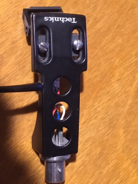

Ok, after inspecting everything, something is off here. There is a Technics headshell with an ATX-14 cartridge, but I believe the headshell needs to be replaced. There are two screws on it but no matter which way I turn them, they neither tighten nor loosen. The washers are either not there at all of they're so thin and tiny that I'm not sure they're even there. The screws sink down into the ridges and I'm not sure if they're supposed to sit on top or not. When I look at the sides of it, I can see a little nut on each side that also turn when I turn the screws.
After listening to it, the high end is missing. I think I'll pick up a new cartridge/headshell combo as I was kind of expecting to anyway. The AT120eb with the matching headshell is what I'll go for I think.
don't read too much into this, but you have to hold the nuts. Tweezers work, but you can probably just wedge a screwdriver between the nut and the cartridge body to get the same thing done. Or if you've got a set of ignition wrenches for adjusting points, possibly one is small enough.
You will still need to be able to align the new cartridge. The 52mm method will work just fine for that arm.
There should be washers between the screwhead (which should be on the top side of the headshell) and the headshell.
For most cartridges, there should be nuts at tne end of tbe screws (bolts, actually). These must be held in place to tighten the bolts.
However, some carts have threaded sleeves, and need no nut. Much easier...I don't know why this is not more common.
I mention these things because I am not sure your current cart and headshell are faulty...other than perhaps missing the washers. Perhaps the issue is more of a cockpit error than a mechanical issue.
Pics would help readers provide more precise diagnoses and suggestions.
I posted a couple pics above, but I can take more if you need them. I'm absolutely positive that the stylus on this thing needs to be replaced because it sounds like a hefty LPF is rolled way back on everything, so I'd like to get a new headshell/cartridge combo. The AT120eb looks good. In the meantime I'll work on the one I have, eventually get a new stylus for it and use it as a backup.

There is nothing wrong with the headshell. the screws go down into those slots.
If the nuts are turning with the screws you simply have to hold them as you tighten.

Everyone mentioning to hold the nuts must be blind lol. Can't you see in the pic he needs spacers? The screws are TOO LONG and running out of threads before tightening down on the cartridge, simple as 1, 2, 3 lol.
No wonder so many find installing a cartridge difficult ROFLMAO.
Anyone thinking it's difficult installing a cartridge on a removable headshell should try it with one that's fixed, then you're really having fun lol.
Actually, now that you point that out, perhaps those are metal spacers on there that can be removed.
and yes, those are really long screws.
