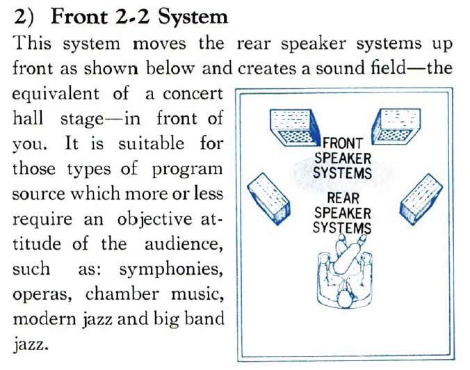

PS ... common misconception is that quad needs four identical speakers equidistant from the listener ... not true. Put em where you want em, and tune the room accordingly. Another standard solution is to put the rears in FRONT of the listening position and to the sides.
