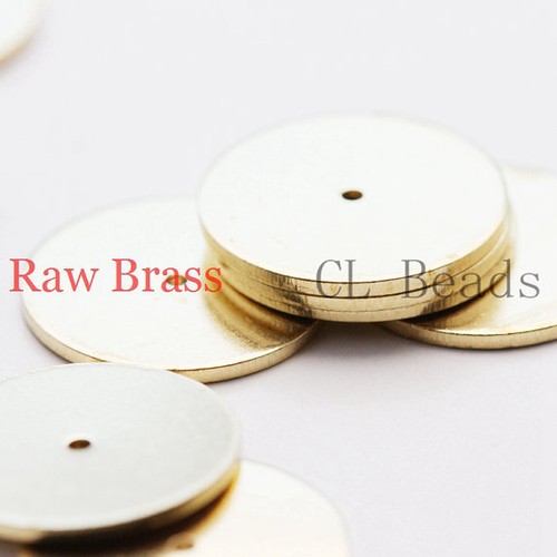

So, Glenn, can you help me to understand how the pots work? Here's one opened up:
So, you've basically got a wirewound resistor that's tapped at a point determined by the turning of the "dial." I can understand that, if the metal on the disc were removed in spots due to pitting, then the tweeter would just drop out entirely when the inner tap point was over that missing metal. I don't see how anything that happens inside the pot could result in a gradual change in tweeter response. Wouldn't any change due to deterioration of the pot be an on/off kind of thing? When I first opened this thing up, substantial chunks of the inner disk were just missing. With an ohmmeter on the terminals, the reading would just go to "OL" at certain points. Even now, one of the pots doesn't make a good connection at one extreme, so I can't turn it all the way up without it simply dropping out. Otherwise, the change in response is smooth.
If you want to repair the original discs, beadmaker suppliers sell a brass disc
that fits. You'll need a small screw and nut to secure it once you drill out the
original rivet. Something like this. (14mm). I think I was able to find a US
supplier, and you might somewhere off ebay.
