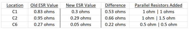

After 40 years, I decided to try improving the sound quality on them by replacing all the electrolytic capacitors on the cross-over board but not any of the film capacitors. Access to the cross-over is from the bottom of the speaker cabinet. I replace each non polarized capacitor with an equivalent value one that I could get from Parts Express and MadisoundSpeakerStore.com. The outcome of this initial phase of the retrofit was a boomy base that was unpleasant sounding.
In the early 1980s, B&W used the ELCAP non polarized capacitors for their speakers that had rather high values for ESR. B&W at that time designed their cross-over circuit taking into account the higher ESR values. Nowadays non polarized capacitors typically have much lower ESR values.
To eliminate the resonance in the base and mid, I decided to add an external resistor in series with each of the 3 shunting capacitors in the cross-over to increase the ESR back to their original values. To determine what value external resistor to use, I measured the ESR value on both the original and the new replacements non polarized capacitors and use the difference. I did the measurements using a Peak Atlas ESR70 ESR & Capacitance Meter.

I was not able to find the schematic for the B&W 802 Series 80 anywhere. However I was able to find the schematic for the larger model in the series, the B&W 801 Series 80, which used basically the same cross-over circuit but with different component values. The extra resistors were added to C6 and C2 in the base section and C1 in the mid section. C3 already had an 8 ohm resistor in series with it so I didn't bother adding one to it.
Resistors Added
