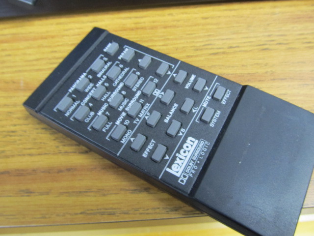

Speaking of which - my latest audio purchase was a Lexicon CP1 ... Amazing device for fine tuning your environment, with an incredible amount of options, but without the remote, it's a brick, as there's minimal buttons on the unit and no way to access the menus for the tasty bits.
