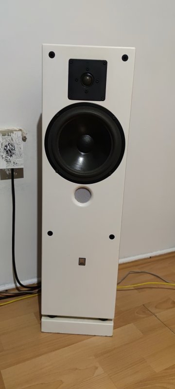

Hello, I'm new to this site, but I've been into audio for a long time, and am even making my own album! I've created an account to post about a peculiar problem.
I have these very cool speakers "ATL CELEBRATION" and they have this problem where both the bass and the tweeter play at a slightly higher frequency than they're supposed to, leading to a saturated tweeter sound and higher bass sound.
I've heard somewhere that an old capacitor can lead to the problem, and after successfully replacing the capacitor, the problem remained.
They still sound really good, meaning that the drivers are probably fine, but I really have no idea what the problem is, any sort of help would be appreciated.

Update: Unfortunately, it seems like it is the tweeter. We replaced the tweeter and put it on the other speaker, and it still has a problem.
I was so certain that wasn't the issue, but I guess I was wrong.
I should probably sell it
My problem is that i don't see what the problem is. It's such a barely noticeable issue, I'm so
I mean, look at it!
I don't see any problems, even the magnet looked fine!
What kind of a specific and barely noticeable issue can a tweeter have?
voice coil rubbing perhaps. If you have a signal generator, you could loosen the four bolts around the dome and move the dome/voice coil slightly while playing at a low volume to see if the noise clears up.

The problem persists on the tweeter.
Ive noticed that the voice coil is a bit to the side as opposed to center place.
Could that affect the sound ever so slightly?
You should disassemble the tweeter to look inside. Many different problems could cause distortion.
A tweeter VC going off center , even if possible, would be quite rare. The VC is very small and light and the glues are strong. But it could be damaged-burned and the wire detaching from the former, or some other problem. Some dirty or debris inside the magnet gap for example. Or simply off center. The only way to see it is looking inside.

Hey, I've disassembled the tweeter and boy is the magnet heavy.
Will I not get electrocuted touching this?
Should is use some protective gear?
I'm also noticing (might not be clear on the image) the yellow sponge specs are stuck on the back of the dome. Can that affect sound by giving it harsh sharpness?
The dome itself looks perfect.

I have some photos (the closer tweeter is the one that's fine, and the further one has a problem).
I don't want to replace them, these are killers, I really hope there's something I can do.
Idk how images work on this site so sent these as full.IMG_20221031_144830.jpg IMG_20221031_144814.jpg IMG_20221031_144800.jpg IMG_20221030_152249.jpg IMG_20221030_152233.jpg
Try using some paper to swish through the voice coil gap and see if there is any debris in there. I cut up a coffee filter for this. You might even put a little WD40 on the filter paper so small specks will stick to it. That looks like a big piece of foam to fit under a dome. Could be some flecks of the foam in the gap. If you don't find anything in the gap, then it makes me more suspicious that the coil may have been rubbing slightly. Is there any evidence of rubbing on the the magnet wire varnish? It's hard to tell anything about the voice coil from the straight on view. It does look like there is something on the left side of the VC in the picture. Almost looks like the former is bent over a bit.

I took some more pics of the vc at angles.
BTW, should i replace the yellow sponge, and if so, with what?
Thanks for all the help, I'm more of a computer software guy than an audio guy.
Vlad.
The VC former does look a little rough around the edge but you'd have to be very careful if you tried to smooth it. Something round and smooth like a pen barrel with very light pressure might smooth it a bit it that is really what I'm seeing. A couple of the pictures do appear to have scrape marks on the inside of the former. Have you tried cleaning out the VC gap? Not sure I would replace the foam unless it is crumbling or hardening. The other tweeter, which you say is fine, probably has an identical piece of foam.
Leave the foam alone by now. Looks perfectly normal from here.
I agree about a small dent on the VC. Check by yourself, from here is not easy to confirm that.
This is not normal, the VC shows signs of rubbing:
