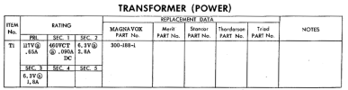

Thanks for that! I'll rethink my math a bit.
The telefunken's transformer may actually be up to the job. I'll play with it again this weekend.
I'm a little concerned about the sizzle I heard when I was playing with it (I was trying different connections on the primaries to see if using one of the primary taps for a different mains voltage got closer to a voltage that would rectify nicely to 270vdc when it started sizzling). Again, it now tests okay, so I'm not sure if I just cooked some glue or did any real damage.
The rectified voltage off the telefunken transformer in the schematic is 252mA at 108mA.
I tried a few different taps on the primary and I'm pretty sure with 120v on one of them, I got into the 220-230 range.
Yes, plan to have bias pots. I found some 100ohm linear 3 turn trim pots that panel mount. I thought that'd do the job.

Unfortunately the screenshots of the schematic are unreadable- AK downsamples quite a bit. If you included the model number, or the link to the model and schematic on Radiomuseum it would be helpful to see more information about the stock transformer.
It sounds like you have a shot at making it work for a DGSE-1 if you can see 220-230VAC (RMS) unloaded. The real indicator will be what the filament voltage is reading when the primary is connected that way. Unloaded it will probably be in the 7V AC RMS range, but you want the filaments (when loaded) to be running as close to 6.3V as you easily can. You don't want a primary configuration that achieves your HV goal, but has to run the filaments above about 6.6V, or below 6.0V as that is not a win long term. No real way to tell how reliable the transformer will be (if damaged) until it's under load for awhile.
Those trim pots- do you know the power rating? One per 6BQ5 will be passing about 50mA through the pot, dissipating about .25W so they really should be rated for at least 1/2 watt to be reliable.
