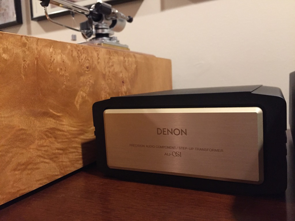

The other pending item was the cartridge. After trying a couple of different ones, I settled on the Denon DL-S1:
Along with its companion SUT, Denon's AU-S1:
A sweet sounding combination!
So, I picked a bunch of quality pressings from my record stash and devoted a couple of weekends just to sit and listen. Critical listening, as they say. :smoke:
From the bass lines of The Ray Brown Trio "Soular Energy" (Concord) half-speed mastering by Stan Ricker, to Dead Can Dance "Into The Labyrinth" on Mobile Fidelity Sound Lab, to Ella Fitzgerald "Let No Man Write My Epitaph", to Willie Nelson "Stardust" on Classic Records 45rpm single-sided clear vinyl (Quiex SV-P), to Frank Sinatra and Count Basie Orchestra "Sinatra At The Sands" on Mobile Fidelity Sound Lab, to Rickie Lee Jones "It's Like This" on Analogue Productions 45rpm, to a variety of Japanese jazz pressings. I threw as much material at the table as I could, always challenging the upgrades (mat, cart and SUT). The transformation in sound was quite remarkable.
Project complete. :thumbsup:
