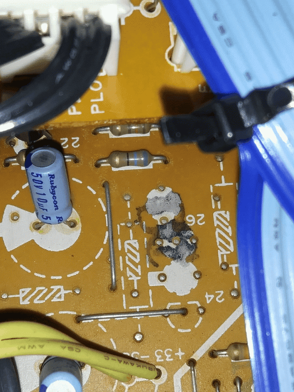

C70: Fuse Blew
The C70 is a great preamp. Avionic is the man when it comes to restoring these Yamaha pieces and has helped me with a few issues on Audiokarma. I hope you can get it sorted out.
This photo shows a space on the C70 board that looks like something once occupied it but was ripped right off. I certainly didn't remove it, so then how is it that this unit has performed well over the past few years? Baffling.
I just checked one of my C-70's .. There are no components residing in those positions.
Check the integrity of that long jumper wire with the oxidized ends . Make sure the soldered ends show continuity. As well as that 18K Ω ( Brown/gray/orange/gold) resistor with the corroded lead. What did the bottom side of that small cap between the two larger caps look like.Scrape off all that dried glue.

Continuity check of that jumper from the back of the board is 0.000v. I'm guessing that's not good?
The resistor is reading 6.7 ohms and going by your 18k reference, probably not good too?
Should be zero ohms from one solder pad to the other solder pad on that jumper wire.
