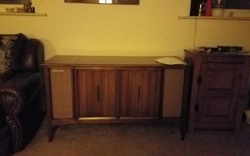

I brought home the console from my parents as they are preparing to move and downsize. It is a Motorola SK163W. Cabinet is in fantastic shape. It sounds like a speaker is probably blown, but the turntable seems to work great. It is turntable only. This is all new to me, any guidance on what I have and if I will ruin it by replacing speakers would be greatly appreciated! At this point I am planning to pull the back off of it and poke around on it. My only audio equipment experience is car audio installations.
Its probably something else wrong with the stereo. Speakers being blown in consoles are really rare. It does happen, it's just rare.
When you get a chance, simply switch the left & right speaker wires just to rule out a bad speaker. Keep us updated. :thumbsup:
Thanks for the advice! Does anyone have any specific information or advice for working on and playing with this particular model? I did see a couple of posts earlier in this thread for this same model number.
SK163 came with the HS-1239 amp chassis. Pretty good unit if that's what is in it. Pull the back off and post some snaps of the amp.
View attachment 1043849 View attachment 1043850 View attachment 1043851 Exterior
Here are the exteriors. Not in too bad a shape. It is complete.
The Good:
Turntable works
Has optional Receiver
it is complete, all parts and trim are there.
The bad:
The receiver does not work, though it turns on
the turntable has a bad channel - wavers up and down in volume (not the preamp/amp)
The amps right channel is a bit weaker than the left
I'll recap it then get a new needle for the 'table and see how she does.
